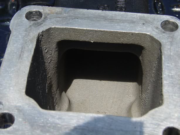

its not about making more power its about more volume and lowering egts
take a look at the castings
not quite a 3" tube is it???

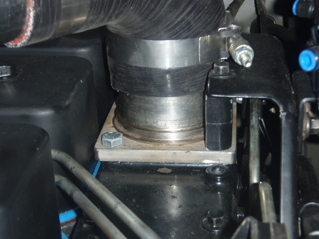

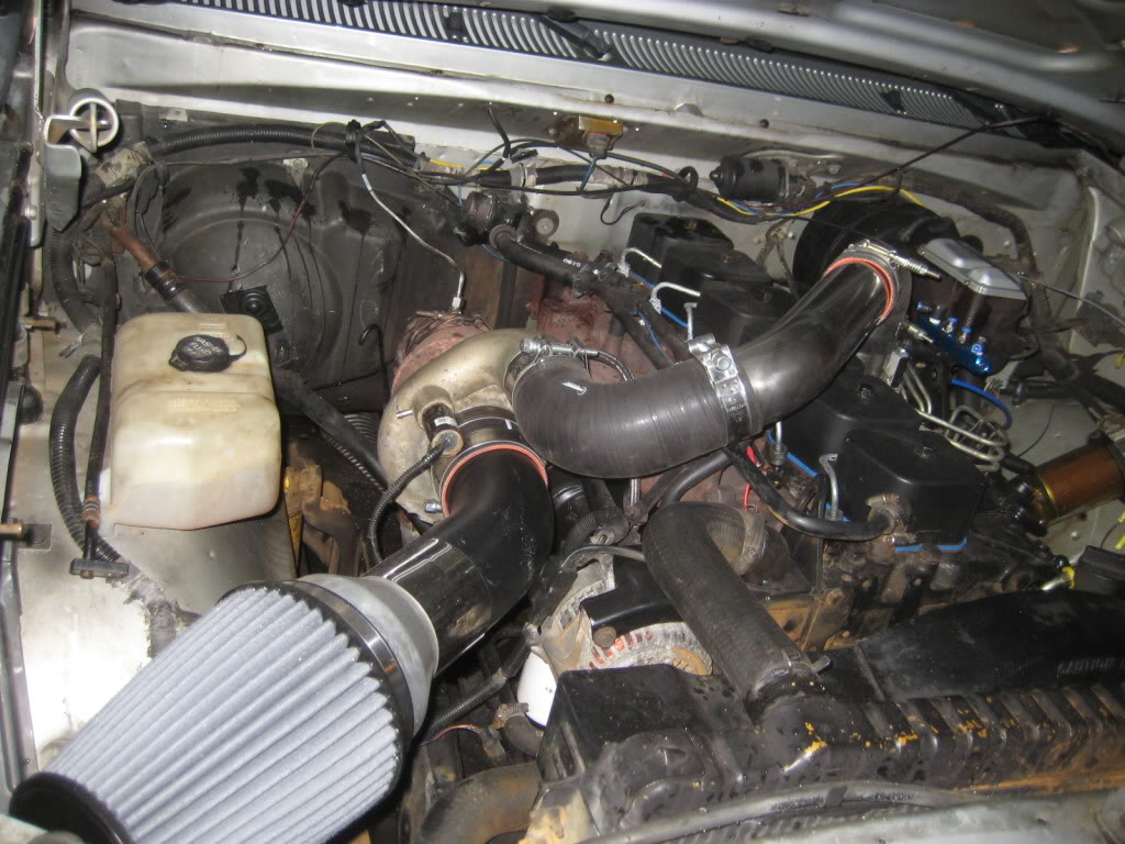

this is what i run

nice non i/c HE351CW setup there, Diesel Dog.
Here's mine. I have only a 2.5" pipe and inlet though...
P1000477.jpg?t=1272155884
P1000478.jpg?t=1272155946

Jbrad, All you gotta do is make a pipe with a 45* bend in it about 2" out of the cooler, you'll need a 2.5-3" adapter boot and a 3" boot along with clamps
