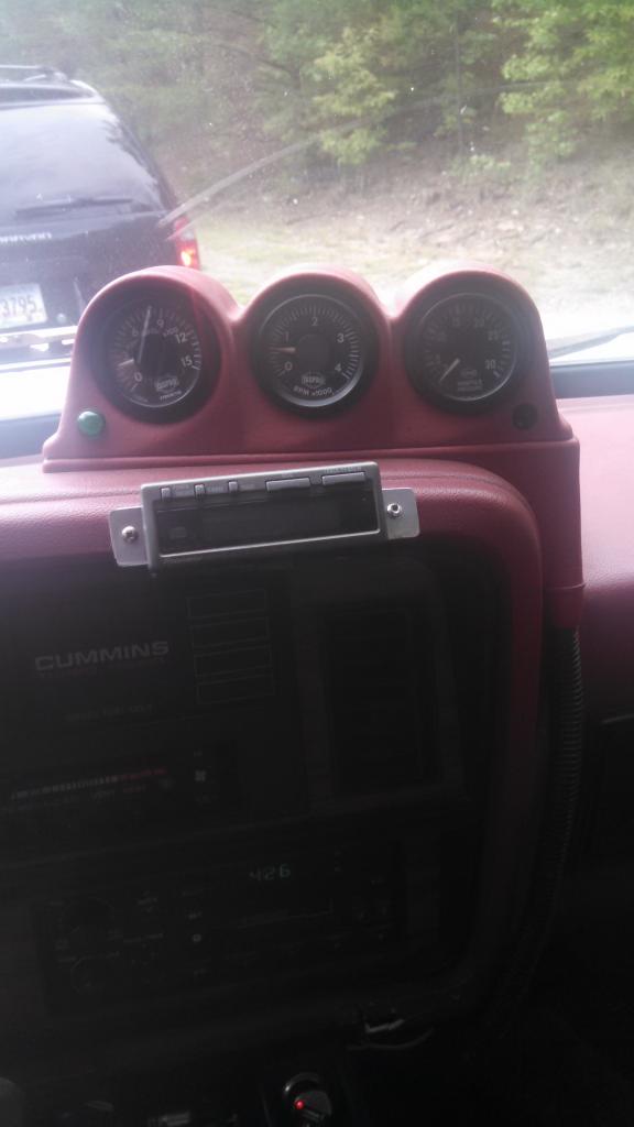

Well, that takes care of the lights. Now the gauges inside, you said you thought they may have been put on by previous owners. My only issue with that is that the housing around all the gauges is the exact same color as my dash. Not even a little different in color. It was the same on my previous 1st gen too. Just 2 different color interiors. I'll see if I can upload a photo tomorrow. It'll be the first photo I've ever uploaded here so hopefully I wont have too much trouble. Funny thing is, half the time only 2 of the 3 gauges work at any given time. The boost always works but the egt and tach alternate between which one wants to work. Its rare that they're all going at once. Wiring is the bane of my existence I think. Haha! Fortunately neither my first truck or the one I have now have any serious issues with the wiring.
I forgot to mention, the housing with the gauges has a red and green light in the corners of the housing. In my old w250 I seem to remember that the green one would light up, but on my d250 I've never seen either one lit up.
Those housings are more then likely as old as the trucks themselves. My guess would be that they were a factory dealer accessory, and therefore made in the correct interior colours for the new trucks at that time.

Anyway, at this point I may want to change them or at the very least fix the one I have. So, if I change the ones I have is there a preffered brand? Are they difficult? At this point I guess I could just follow the old wires. But do I need to remove the dash? Honestly wiring terrifies me. I always feel that one screw up with a wire and my truck will quit working. Can I re-use the wiring?
It should be a 2 piece affair, with the top held on with two screws. Easy to work on the wiring and plumbing inside.
Usually the wiring and plumbing will come up the dash (in a loom) and up that leg hanging down the right side of the pod. You can drill though the dash too, if you wish.
Pulling the front of the dash off gets you access to the top of the dash if you need it. If you come up the leg as described above, you don't need to.
I would think that you probably just have some bad connections somewhere, that is why the gauges knock out from time to time. I would trace the wires back under the dash and see what's going on.
Make sure all your connections are good, and that the grounds are clean and tight. And no corrosion on any connections.
yes, sounds like a short. Double check the grounds.
Those dash pods are nice, and scarce. I have a 2 holer and wish I had a 3 or 4. Looks like the PO just painted it to match. I think they all started out black.
