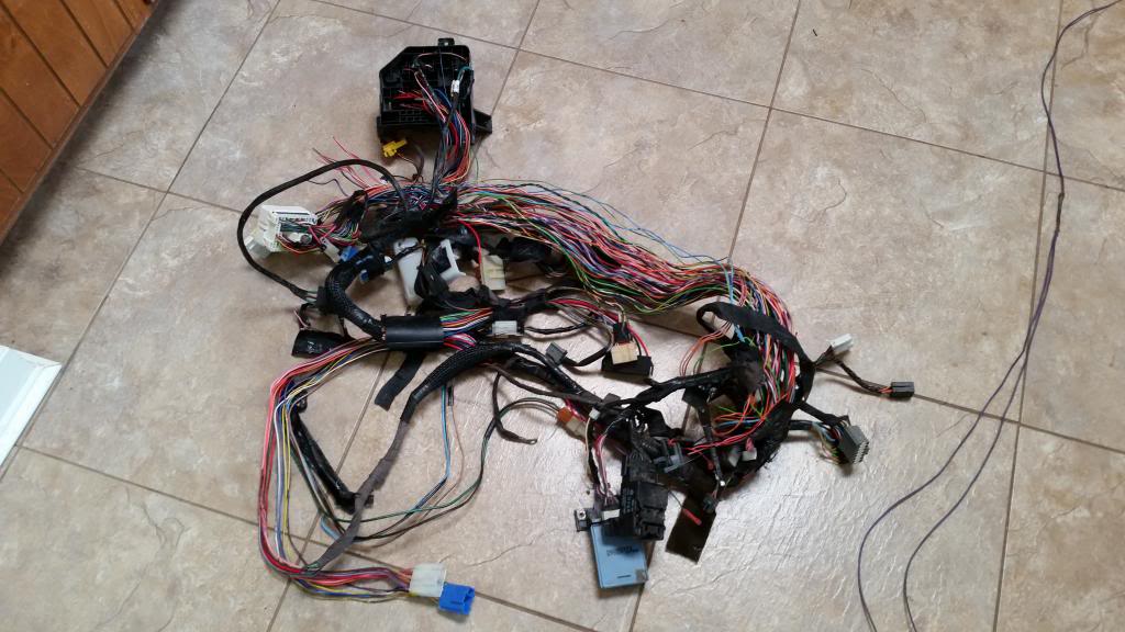

Here's a factory under-dash harness for a '95 12 valve that I'm cannibalizing for my 2nd gen dually. Plenty of adhesive electrical tape on this, even more so than dry vinyl. You can see the black glue residue left behind, especially on the cluster of wires on the far left towards the bottom that lead to the blue and white female connectors:
