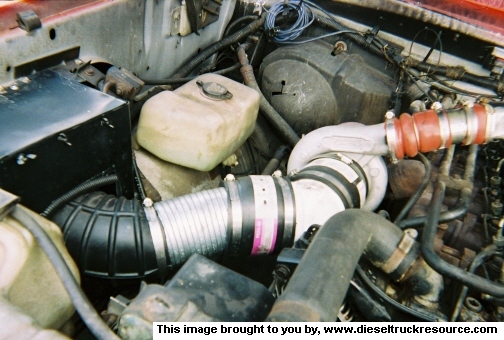

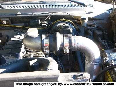

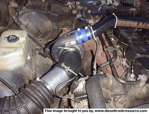

Really, so your running an HTT III and POD's with no IC and not running into issues? Thats awsome. If I knew I could do that I would have skipped the IC and just ordered the HTT III and ordered the POD's next week. Any pics of how you hooked up the new compressor to th crossover pipe?
Old Oct 25, 2005 | 01:17 PM
G1625S's Avatar
Joined: Mar 2004
Posts: 4,767
Likes: 5
From: port crane, NY
It's only a WH1C, but exterior dimensions are the same. It's a little tricky when retaining the stock crossover pipe, but it's what I plan to do. Thanks to member Edwinsmith for the pic.

[IMG] [/IMG]
i dont like the pipe going to the turbo on mine but when i get home from college this weekend i am going to change it i have all the parts ot my house
the 3200 spring and afc grinding are soon to happen as well
Old Oct 25, 2005 | 01:28 PM
ihpower's Avatar
Joined: Jun 2005
Posts: 354
From: Orient Oh
its sealed up tight but i dose not look good AT ALL. but its all peices i had around the house
