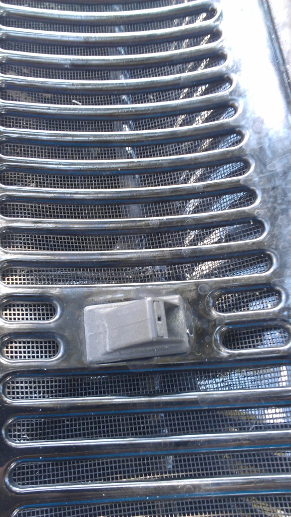

Could someone have done the screen prior to y'all?
Originally, I had cut the heater box () to clean it and wound up with the condensation leaking onto the passenger footwell since I'd forgotten to punch out the drain line. I guess I'll eventually replace the box, but everything is cleaned out andthis will keep out future crickets, petrified baby birds, leaves, juniper berries and mescal beans out.

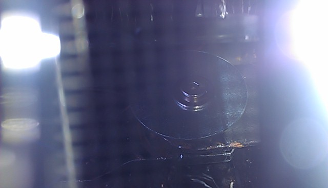

You can see the head of the bolt (6-32 x 1") along with a fender washer. There is a lock washer, nut and blue locktite on the bottom of the arm.

Figured out a use for the old torn screen from the sliding door.
Did you bolt through the nylon bushings after drilling them out, or ???

I pretty much followed BK's original guide by drilling out both the pins and the bushings prior to assembling the whole mess. On a side note it was intermittently dumping buckets of rain here this past weekend and so they wipers are doing well.
