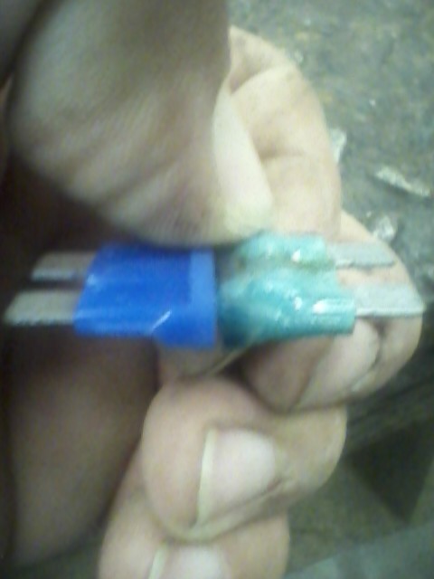

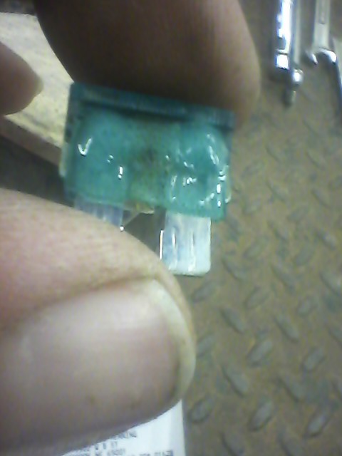

I think we've got a dead short here somewhere.
No wonder the body lights weren't working!
I don't know how it didn't burn the truck down, either.
We have everything from the battery forward removed, and started on everything under the cab, short of the fuel sender. The ABS unit has been by-passed so those wires are coming out, too.
89 D350 c/c, with a flatbed on it.
Oh, that was a 30 amp fuse that melted. We popped a 15 while working on it, and I do mean popped. I heard it let go while checking for function on the wires we were cutting out.

Those don't look like genuine BUSS fuses; any other brand of fuse will melt just like pictured.
Actually, the old glass tube fuses are much safer in that they will "shoot" and not melt.

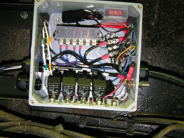

Under my truck is a waterproof junction box with fuses and relays in it for all the trailer circuits except brakes. If a trailer circuit shorts out, it takes one fuse out of the truck, leaving all truck lights and the rest of the trailer operating.

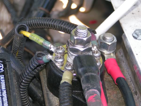

I remove the blower circuit and power-window circuit from the fuse-block AND key-switch, routing them with much bigger wire to battery HOT --- NOT the post on the battery, but a remote stud I have added for such purposes.
Like this?

Here's my under carriage trailer relays.

Originally Posted by j_martin
Like this?
Yeah; very similar, except due to financial constraints mine are home-made.
Years ago, I discovered that wires and terminals lived a lot longer when they were not connected to a battery full of acid and the resultant chemical reactions.
Instead of having dozens of corroded wires and ring-terminals, the only thing rotting on the battery post is the short cable that feeds the remote stud, and it will last a long time if things are kept tight and slathered with Vaseline = the best thing to ever happen to copper wires.
