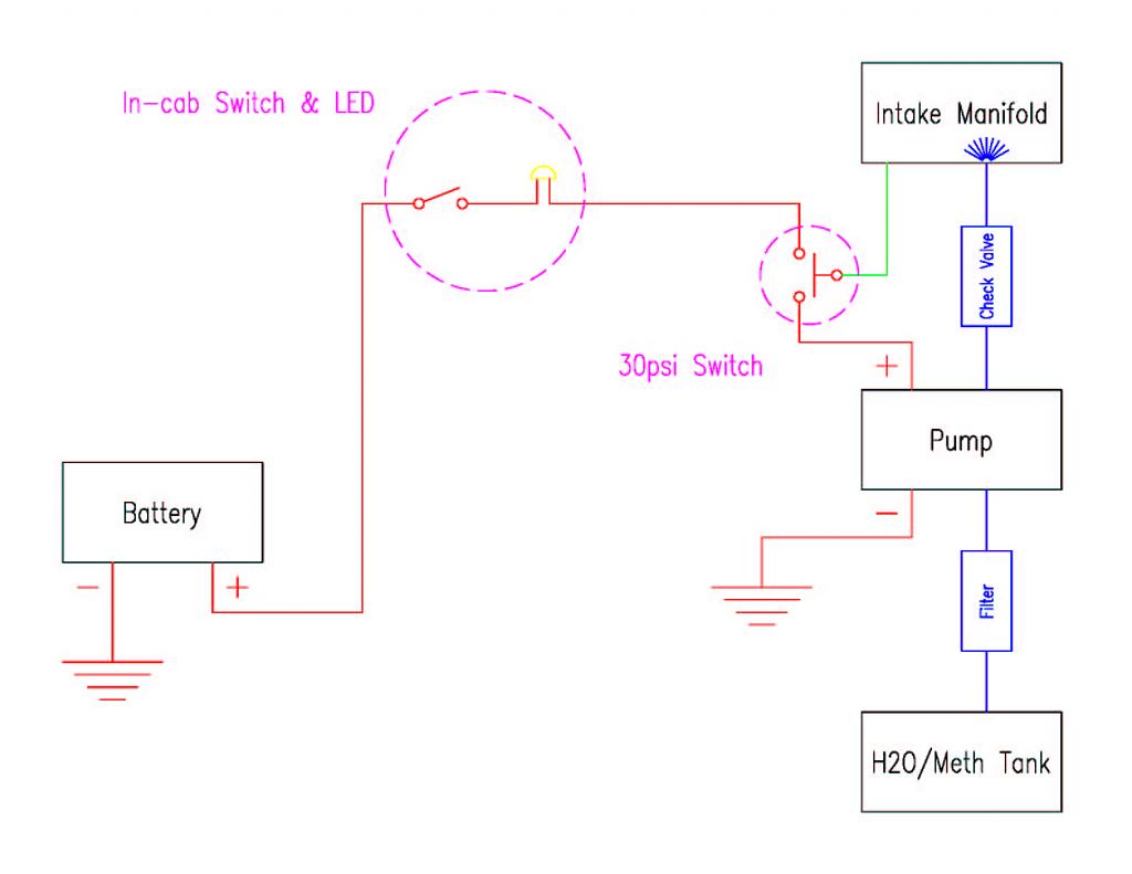

Use a pressure switch like this:
http://www.gemssensors.com/content.aspx?id=1200
Run a 12V power lead from the battery or ignition > in-cab switch > in--cab LED > pressure switch > pump. The pressure switch is adjustable to allow fine tuning of the boost pressure trigger.
Seems quite simple to me.
I'd drill/tap the intake for two nozzles, then mix and match nozzles until you get the flow that matches your engines needs. Also, as stated in a prior post, plumb in a check valve as close to the nozzles as possible.
Get the fittings at Home Depot/Lowes etc.
Get the pump and nozzles at Coolingmist.com
Get the check valve here:
http://www1.mscdirect.com/CGI/NNSRHM
(catalog pages 4009-4010)
Hit the switch to enable the system. When your boost hits your target psi, the pump will activate and the in-cab LED will illuminate.

svanni just for the record the scematic you posted, that check valve doesnt need to be there. All surflo as well as flojet pumps have a built in check valve, plus it needs to be a solenoid, that will assure two things,
1-water can not siphon into the intake when system is off
2-the system will stay pressurized between uses.
I know iv said this probably too many times, if you build your own, do it right, listen look and think, w/m can cause damage if applied wrong. If done right its a great HP boost plus its cooling effect, it has no ill effects,
In your schematic, how are you passing all of the current from the pump through the LED and switch is there something I am missing?
Jim
Correct however if the pump is going to be mounted in the bed or a long distance from the intake manifold another checkvalve should be used
