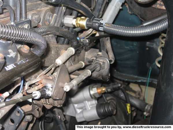

First you are going to need to slightly loosen up this little bolt right here circled in red. The LITTLE head, not the big bolt it's in
NOW- Look down at the little fuel lift pump at the BACK of the engine at the BOTTOM on the DRIVERS SIDE. you should see a little lever on the pump, pump the heck out of that little lever, you should see fuel coming out of that little bolt you just loosened after a few pumps,(in the pic above), pump it quite a few times then tighten the little bolt back up. HERE"S THE LIFT PUMP, the lever you need to pump is circled in red.
Ok now try to start it....If it still doesn't start. See below

Just to pinpoint the "lift pump" a little better for you here is a picture of the surrounding area and the pump. In the bottom of the picture is a new looking item and that is the lift pump. Parkers probably looks different that the one in the pic as it is a new style pump in my pic. with mine you just press in the black acordion looking thingy a bunch of times. Parker will have a smaller pump that is roundish and has a lever sticking out perpendicular to the engine. That is what Brandon is talking about pushing down and up.

You should only have to bleed the filter of air. Try starting it after that. If it runs but runs rough, just hold the RPMs up a little and the air will bleed itself out of the injectors.
