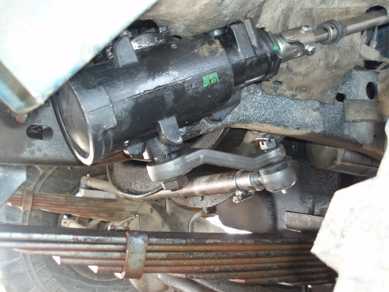

Trying to put on a cross over steering kit but it looks liek i have to move the steering box. the manufacture says it should just bolt right in without moving it forward or back but it looks like i have to move it back but i cant push it back any further. idk what to do please help. what have u guys done before?

You have to remove the stamped steel bracket from the 4wd conversion, then the steering box will bolt on with four bolts to the frame. The steering box moves slightly on the frame. I was able to reuse the 4wd power steering hoses by rotating them slightly.
This is the position of the box on my conversion in the '2wd' location.

I suppose you could leave the box in the stock 4wd position and run a different pitman arm, but everything would end up in a rather odd position.

Other notes....
I think if you use the factory steering shaft you might have to shorten it, or at least drill out a pin and slide the shaft in further.
You may have to trim the front edge of the engine crossmember if the pitman arm doesn't put the drag link in a good position.

Could you use a pitman arm with more offset???? If one can be found.
