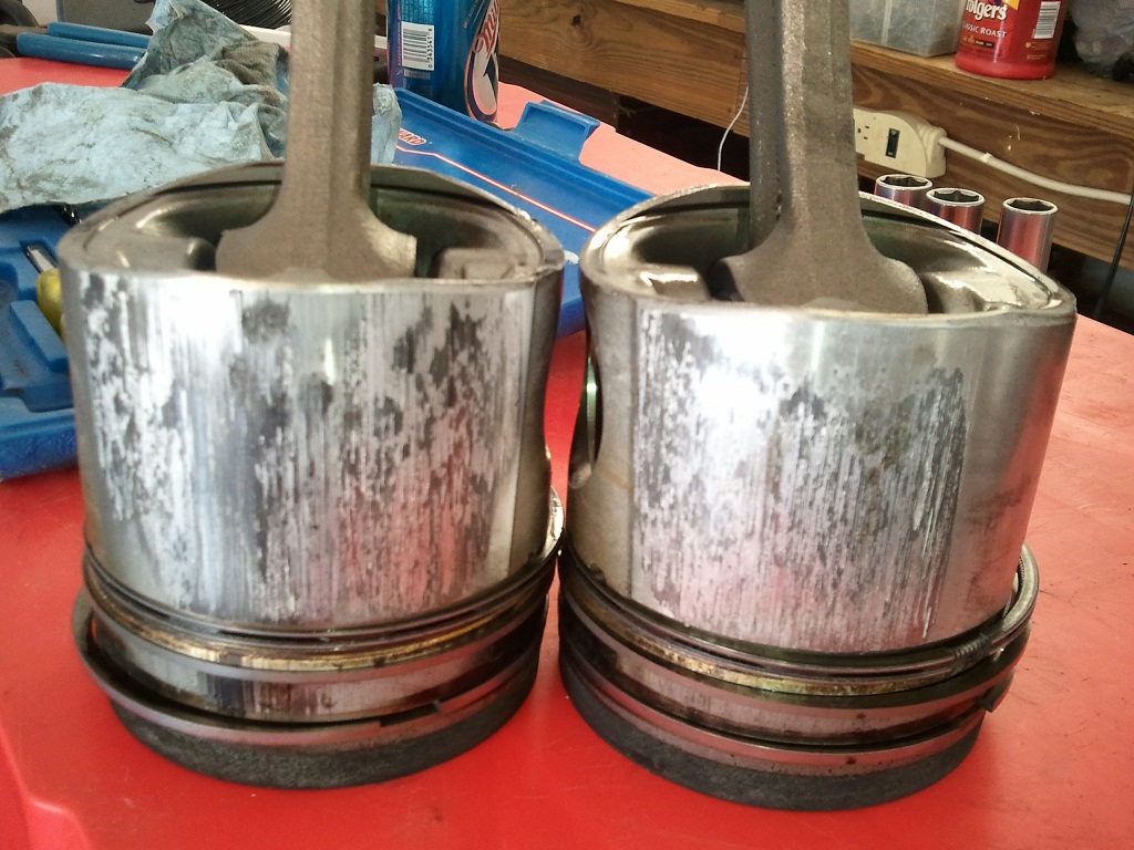

Finaly got the motor torn apart and in the machine shop. Two cylinders were BAD!!!
Check out the #2 and #6 pistons. The other 4 pistons looked great, but these 2 look terrible.
QUESTION FOR ENGINE BUILDERS.......I'm going .040" over. How much bigger should I make the cylinder than the piston???? I'm thinking .005" over???
Attached Thumbnails Finaly got the motor torn apart and in the machine shop. Two cylinders were BAD!!!-2011-07-07-15.15.13.jpg   Finaly got the motor torn apart and in the machine shop. Two cylinders were BAD!!!-2011-07-07-15.15.45.jpg

I thought the cylinders were replaceable sleeves? Looks like you blew a ring land on the pistons? What scored them up so bad?

I'm really not sure. I know the engine has had the head gasket replaced at least once from overheating, and tore one waterpump up. So it could have been from running too hot. The rings were good on the pistons, no odd wear on them. The main bearings and rod bearings showed some wear but not too bad.

Yeah, might have had some high EGT's.. I don't know much about diesels.. learning (: subscribed!

Our motors are known as some of the "throw away" diesels. Heavy duty truck motors can be sleeved, ours can't.

I would go with more that 5 tho on the piston to wall. That is basically the stock clearance. Like was said awhile back, top ring gap is important too, when you get them extra hot. I am sure they know, but they need to fit the bores to the pistons.
You can put repair sleeves in the block, if needed.

It's pretty simple. Look up the original bore spec and go .040 over. That is why they send you .040 over pistons. The proper clearance is automatic. Your shop will know what to do when you tell them bore it .040 over.

If I read this right, he thinks you cut .045
The best thing is to get the pistons first and match them to the bore. The pistons already are slightly smaller than the bore. That's how it's done
Yes it can be sleeved, but that could be allot of money. If that's the case, you are better off buying a used motor and use that block

What you need to do is look at the tolerances in the FSM and try to hit the middle of the range. You should not guess on this stuff. The Non-IC engines are not sleeved from the factory, but any engine can be sleeved. I am not sure when they started sleeving the engines from the factory. This is where a good machinist really earns his money. There are tolerances for rings, pistons, ring gaps, out of round, you get the picture. I would take it to a good machinist and he can tell you what it needs. Bore it out the MINIMUM that will bring it into tolerance...Mark
