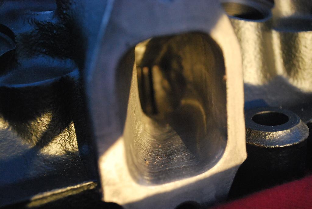

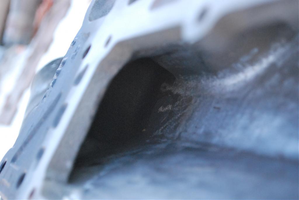

So I just put my head on without the copper spray. Those stinkin bolts get tight! The shorts were 180FT/lbs the med got to 160Ft/lbs and the long 140ft/lbs! This was with moly lube, holes tapped, cleaned and blown dry! My arm hurts!
Should be up and going this weekend, I can't wait to see what a differance this head will make!

Let us know how you like that porting! that looks good, I plan on doin that in the future!

I hope it's good. I'm like a kid at christmas! Did you notice that the hump is gone? Robb took lots of metal out of that head! And gave me some sort of valve job. I don't know the angles but we'll see how it works!
