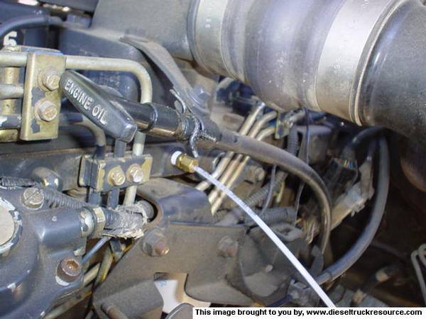

so i finally descided to put my glowshift 3in1 in today, but now i am wundering where do i hook the boost senser hose too? do i have to cut the boost line goin to the injector pump?

It goes in place of that little plug right below the intake manifold (where the intercooler pipe hooks too), on the driver side of the engine. It's 1/8" NPT

Got this great pic from wannadiesel. Show's a boost line hooked into the factory spot under the intake manifold

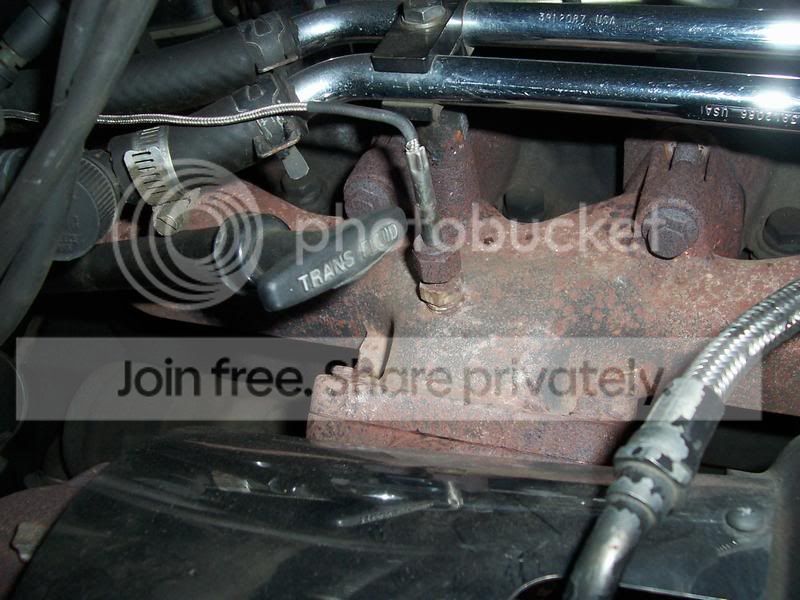

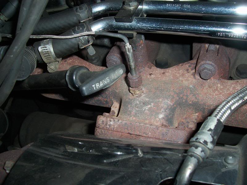

also where the best place for the egt probe on this? and also i got the other temp probe that i havent descided where to put it

About 2" away from the turbo in the mainfold and on the back 3/4 mark. DO not put it right in the middle as the manifold is divided.

EGt probe goes here

EGt probe goes here
whats that funny looking thing near the manifold brandon....my truck doesn't have one of those dip sticks
that picture came up on google image results, not mine
