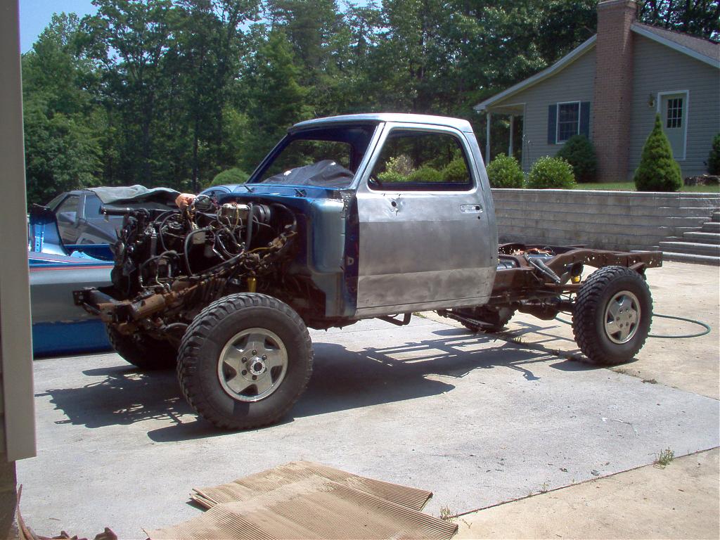

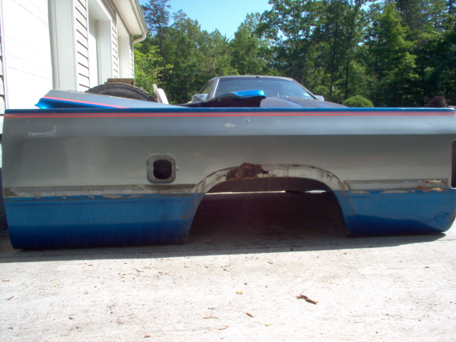

I was wanting to get some paint on the truck and knew I had some issues such as:

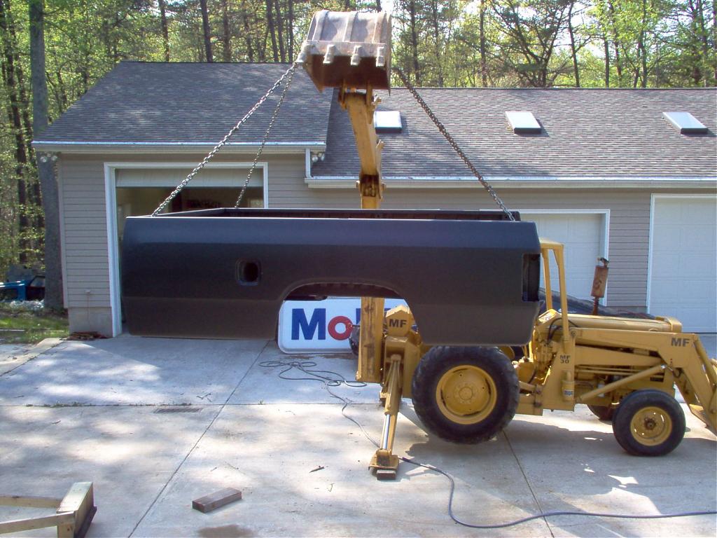

So I picked up another bed which was in real nice shape, it was from an ex forrestry truck. Found a great way to work on the underside for cleaning and painting.

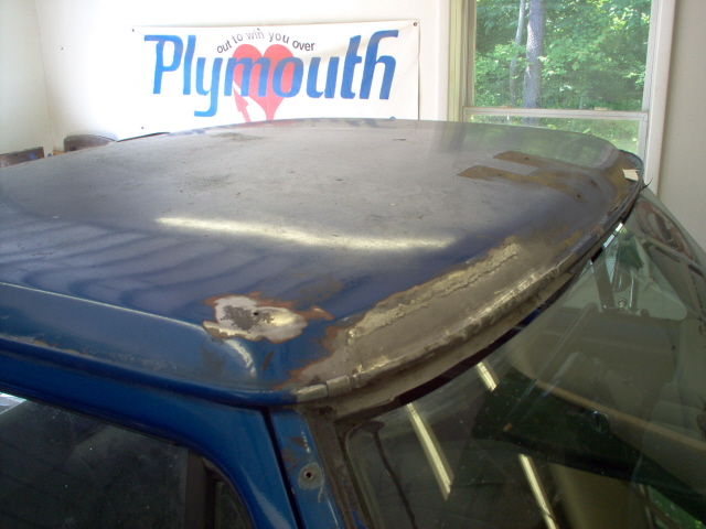

I also found the cab roof rot which I wasn't expecting but had to address.

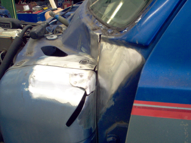

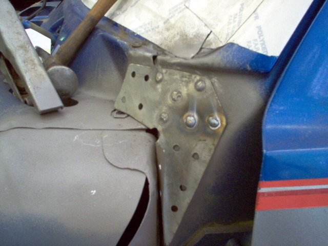

I knew I had cowl cracks on both sides and had to form up my own doublers.

I will also be painting the frame while it is stripped down this far.

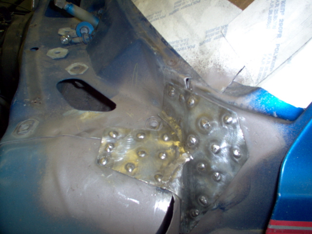

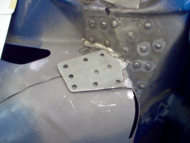

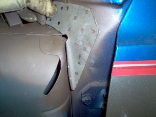

Thanks, here's what I did. The left side was the worst crack wise, as it went to the windshield. After cleaning the old paint and grinding the factory weld, I welded all the cracks and ground them down smooth. Next I cut a paper template for an idea on how to shape the repair patch. I pre-drilled the repair doubler and applied weld-thru coating on the cowl and doubler. I started on the "high areas" and formed the patch to fit. Next I cut the forward part of the doubler and welded it and also welded the seam of the two pieces together. After some seam sealant and paint, only you guys will know to look in there. All you "real" welders, please don't be too critical.

Hey how did you do the roof?? It looks like you just cut out the old metal and put in new stuff. Was it hard. Mine has the same problem I need to address soon. Thanks. Looks sweet though man nothing like a nice straight body and crisp new paint.

did you paint or coat the under side of the bed? what did you use?

The roof caught me by surprise, I didn't think I had that problem. I cut out all the bad metal (which is ALWAYS larger than it appears from the outside) and spot blasted all the surrounding area and the inside structure then primed. There is a stiffener between the outer roof panel and the inner roof panel, this is what I welded the first piece to which I cut in an arc to match the roof line, I left this piece long so I had some material to form the drip rail. Next I welded in the patch. Then I formed the extra length I left for a drip rail with a hammer and dolly and trimmed. After that I tacked on a 1/2" wide "edge" for the front of the whole mess. I also, using a large syringe filled with rust encapsulator, shot across the inside leading edge of the roof line, just because. Now this gets it close and with the visor back on, only you guys will know.
The underside of that bed only needed a pressure wash, scuff and paint. Where there was some surface rust, I cleaned as well as I could and hit it with rust encapsulator and then paint. I have 5 gallons of a preserving oil that dries firm which I was thinking of spraying on the underside.
