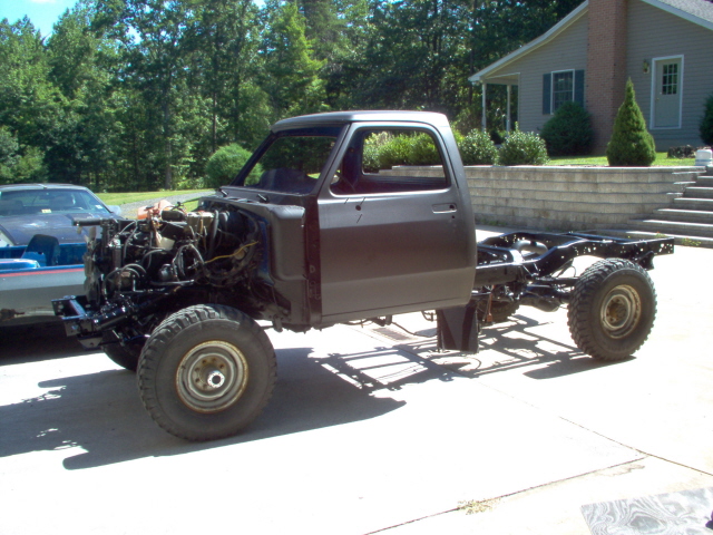

Here's the cab stripped of all the factory finish and someone elses repaint. After stripping I da'd the bare metal with 180 grit paper. I gutted the interrior except for the dash. I wasn't going to do the jambs but I decided to anyway so they just got scuffed.
I see why they had a problem with that factory paint as it was very soft but the factory primer adhered very well to the metal.
After a prep wash I will spray epoxy primer then address the body work. Stripping showed more bondo work than I knew about but at least it wasn't covering rust...man I hate doing bondo work as it just takes me a long time to get it right, I gotta hand it to the pros as they make it look so easy.

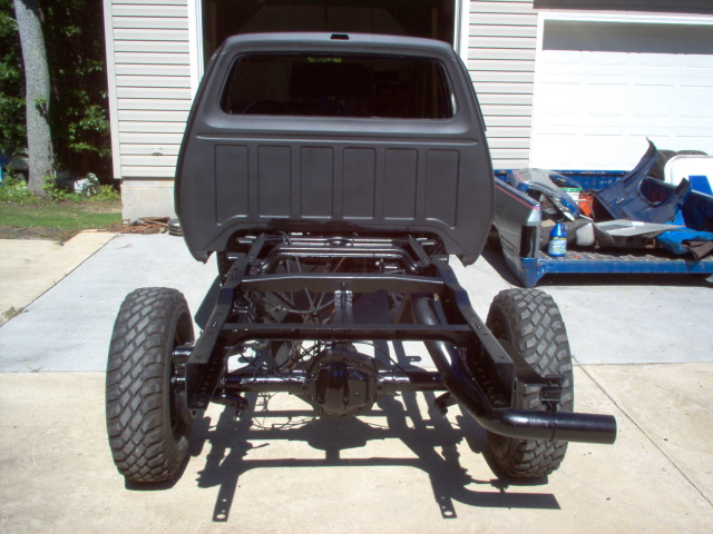

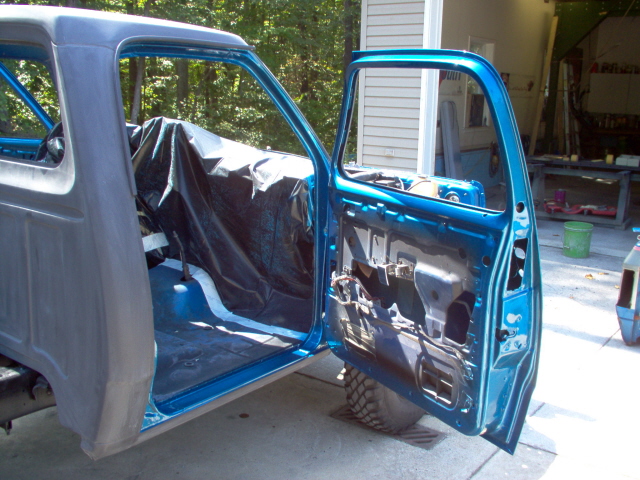

https://www.dieseltruckresource.com/...1&d=1218207743
OK, so here's the cab ready for paint, body work is done and it's sealed under epoxy primer like the bed. Now I just have the fenders, hood, cowl, valance, and tailgate to do.
Once I finished the cab I addressed the frame, it was in good shape so I just wire brushed and scraped it, then I hooked my pressure washer to my boiler for a hot water wash, about 160-170 degrees, that worked well. Then it was two coats of rust encapsulator and a coat of chassis black.
Since it's down this far, I installed the urethane body mounts to help locate everything again.
That roof repair actually turned out better than I expected, like my Dad says, even a blind squirrel gets a nut once in a while.

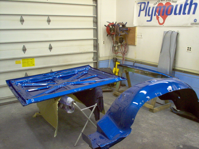

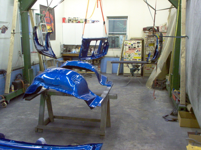

Finally got some color sprayed
OK, here's the inner fenders, inside fenders, radiator support and under hood with some color on. Next is the jambs and cowl, then I will assemble everything and get some paint on the exterior. It's good to be looking at something other than primer.
https://www.dieseltruckresource.com/...1&d=1219894365
Attached Thumbnails Getting ready for paint-im000439.jpg   Getting ready for paint-im000440.jpg

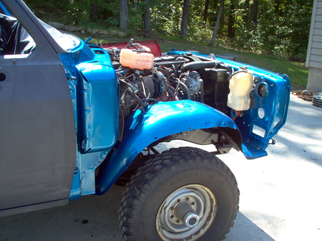

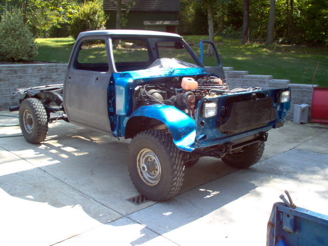

Here's the jambs and cowl shot and started going back together
https://www.dieseltruckresource.com/...1&d=1220477796, https://www.dieseltruckresource.com/...1&d=1220477796
