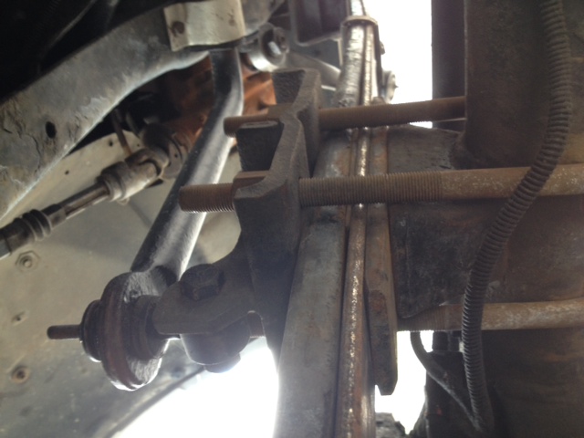

It's not pretty but I've put on over 10,000 miles since I started the first spring modification and I kind of didn't care about how it looked until I knew that what I installed was going to stay installed. In a few of the pictures you can see where the old secondary spring pads used to ride. The reason I chose this leaf for this (hopefully) final mod was because its dimensions closely mirrored the light duty spring pack's secondary spring and it already had the holes in it for the nylon pads, quick and easy. Im sure that you can use something a little different as long as you keep it short enough to let the main leaf flex. I reused the steel shims from the original parabolic set up and reinstalled them in the modified hybrid pack, you should be able to see the pack thickness is thinner than the original.

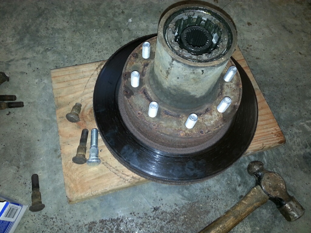

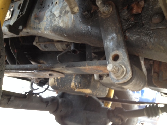

I put mine in today. I forget if I ordered the 2" lift or not. Shocks are 1" too short. I have some spare 2nd-gen rear shocks that look like they should work. Skipped the longer shackles till I get the right bolts.
I broke a 1/2" wheel stud, so I upgraded to 9/16". Other side has to wait... ran out of time today.
So the front is now 1/2" higher than the rear. The rear has sagged out main leafs and factory 6" blocks.
Attached Thumbnails Front Suspension Upgrade-20140626_142848_resized.jpg   Front Suspension Upgrade-20140626_150537_resized.jpg   Front Suspension Upgrade-20140626_183817_resized.jpg
