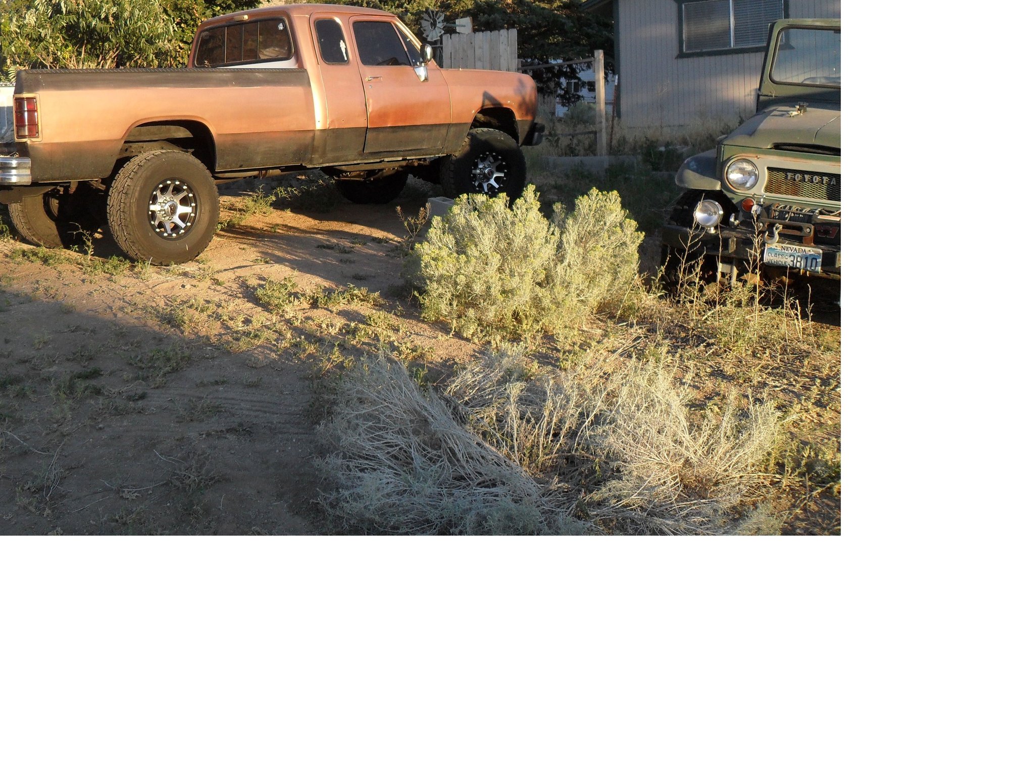

installed this kit in 2012 gained inch of lift over factory springs with helpers up front that had nice frown even after removal
That Landcruser needs a 4bt
