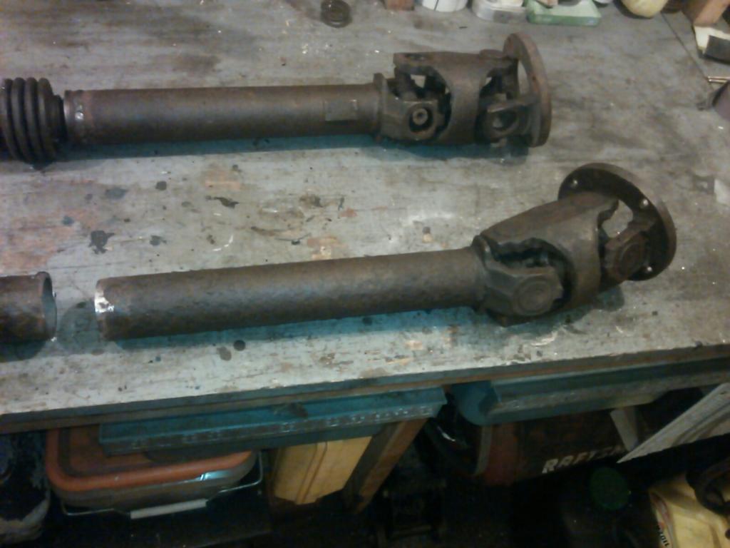

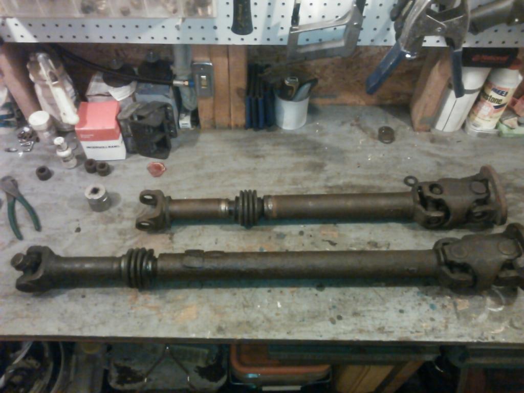

Well considering I am on a very tight budget right now I have decided to use the 1/2 ton driveshaft. I am definitely going to have to shorten it.

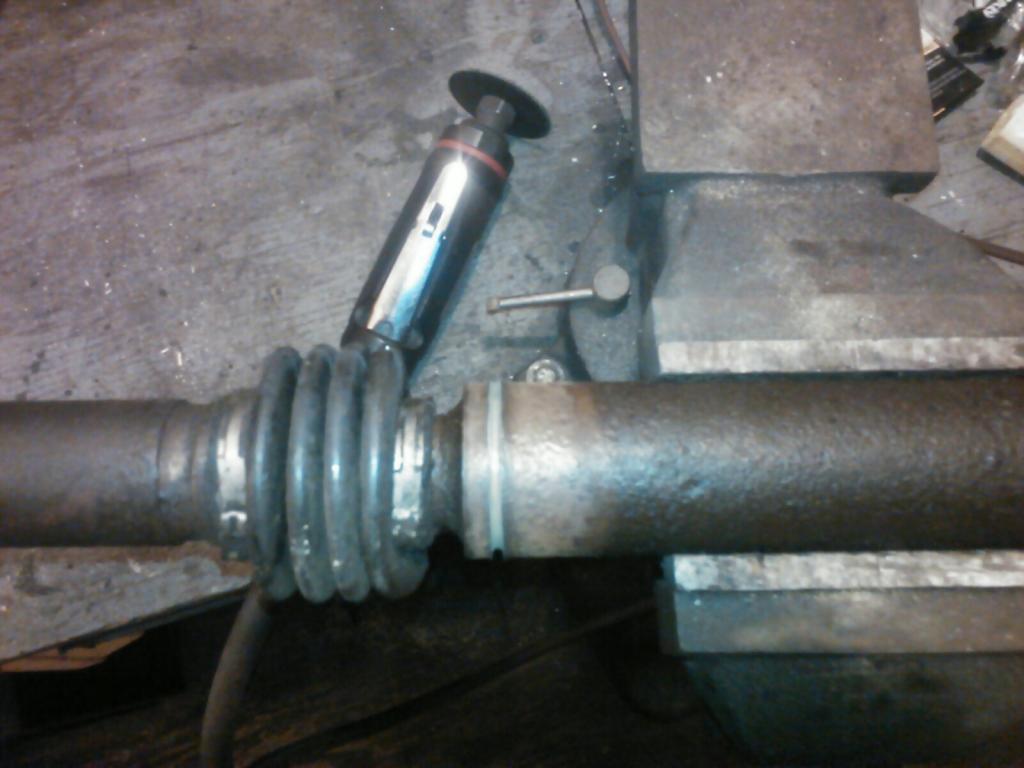

Ok, more snow coming this weekend so its time to get my front driveshaft in. You don't need any special tools other than common shop tools and a welder to do this. Start by measure and marking the tube where you want to cut it. My tool of choice is a 3" air cutoff wheel but any cutting device will work(even a circular saw with a metal cutoff wheel). Try and make the cut as straight and square as you can.

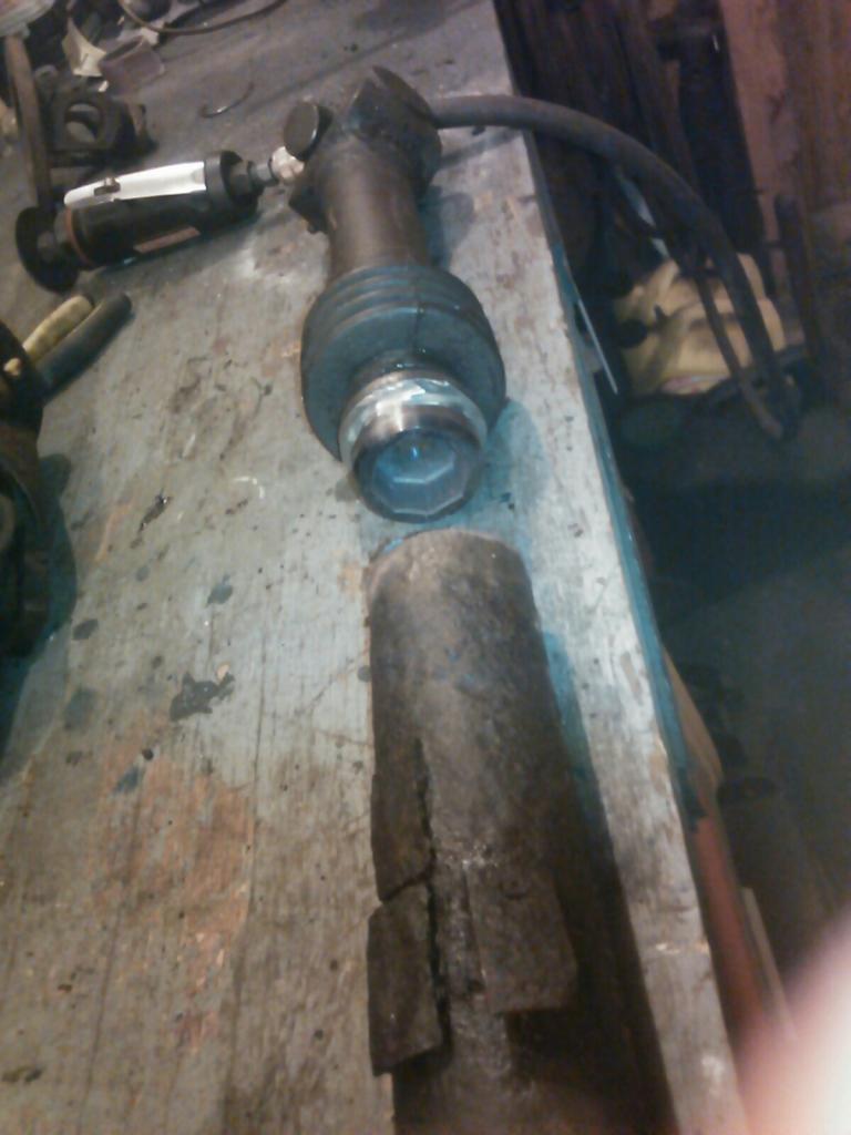

Next you will have to get the splined end out. This means you will have to cut the tube again. Look at the thickness of the tube from the cut you already made and try not to cut too deep, there is a center hub on the spline part that fits inside the tube that you want to keep.
Attached Thumbnails Front Driveshaft-ncm_1303.jpg   Front Driveshaft-ncm_1304.jpg

That center hub is a very tight fit, you will have to wack it with a hammer while forcing it out with whatever will fit in the slot you cut(screwdriver, chisel, small prybar...) Its tight but it will eventually come out. Now you are ready to put the two halves together, but first make sure the splines are sliding freely, they are famous for freezing up. When you do put the two ends together make sure that you line up the u-joints(called indexing the driveshaft). This will help stop vibrations. You will probably have to tap it in with a hammer.

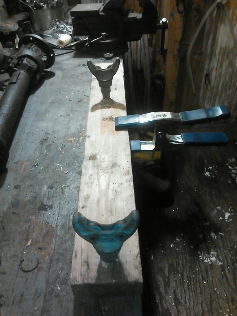

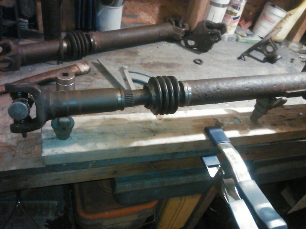

Now comes the part you don't want to rush, getting this thing straight. Here is what I use. You can just use a couple of "Y" shaped pieces of wood if that's what you have on hand, anything that will allow you to rotate the shaft. You can also install it in the vehicle and spin it by hand in the truck. A dial indicator is most precise but you can get it surprisingly straight by just putting something real close to it as a point of reference and watch as you spin it. Take your time, this is important. Then it is time to weld. Tack it in 3 or 4 spots and check it for straightness again. If any heat expansion knocked this crooked you want to know before you fully weld it.

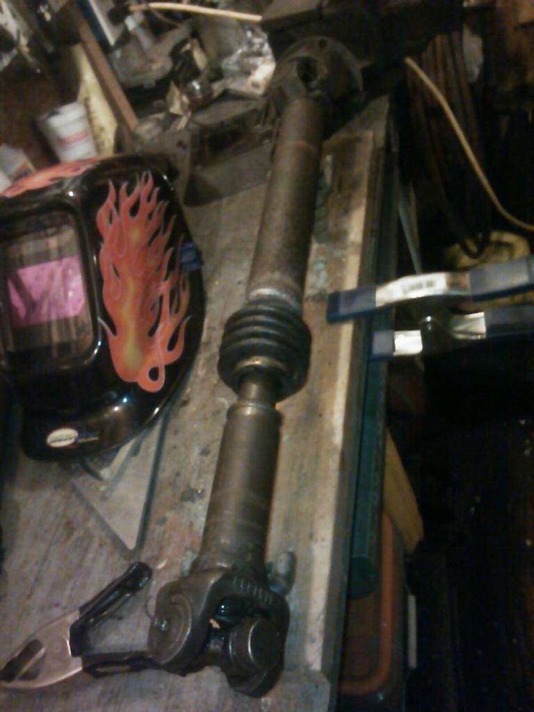

Ok, weld it good. Grease those splines and re-clamp the boot and you are ready to install this thing.
