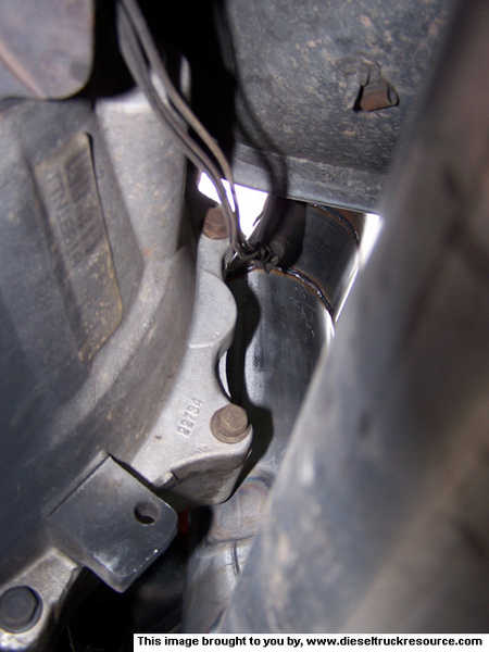

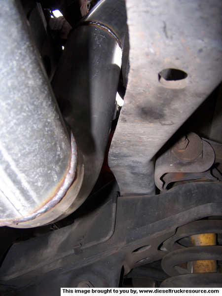

4" will be a tight fit. here are a couple pics for reference. keep in mind that i have an nv5600 tranny on a 2wd truck and i had to dimple the down pipe as you'll see in the second pic.

i don't know of any aftermarket places that make a 5" dp for 1st gens. I may have seen a couple 5" dp's on trucks but can't recall where and i'm sure they were pieced together. looking at mine, i could've shortened the dp and ran it inside the frame rail giving me a bit more room. maybe consider that if you can find someone to build you a 5".
