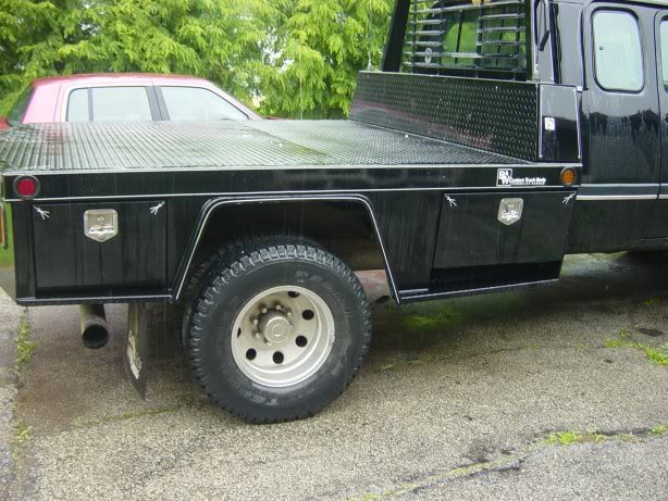

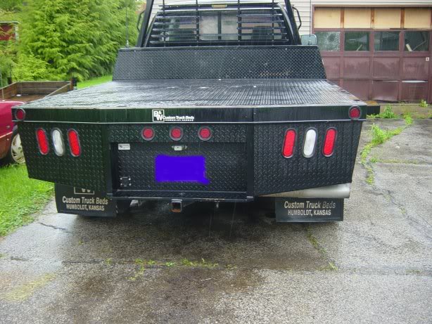

Here you go Bear. Both sides look the same. When I bought the bed a few years ago. This was the only bed B&W had ever built for a 1st gen.
Thanks, Philip.
The more I see, the more I like.
I really like the little "running-boards" step-like thingies along front of the tool-box doors.
I also like the storage in the head-rack.
There is a new company in the next county over from me that is also building some really nice flat-beds, very similar to yours.
