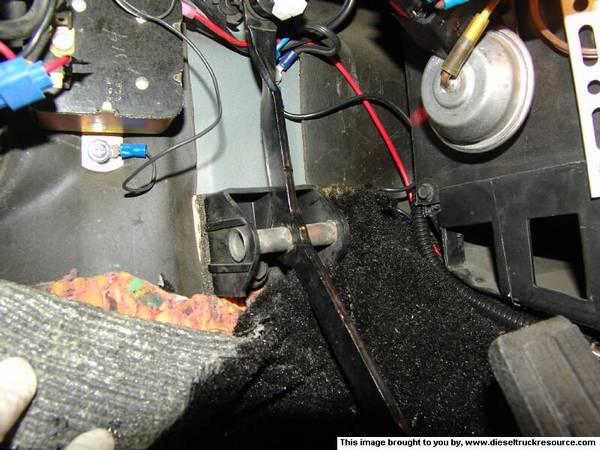

This is the flasher that I am using, it is the gold box in the upper left of the picture, It is made by Dietz and is set to flash at 60 flashes per minuet or once a second regardless of how many lamps are connected. It is made for semi tractors to flash all of the trailer lights and school busses.
And it is purposely made to be LOUD so you can hear it. I have played with the timing circuit inside because I want a faster flash rate with my LED's but cannot get it fast enough because it has a mechanical relay inside.
Because the LED's turn off instantly unlike a filament that have to cool down it has the ability to strobe as they are flashed which is the look I am tying to have.
This one will flash at 360 Flashes per minuet. Hmmm
