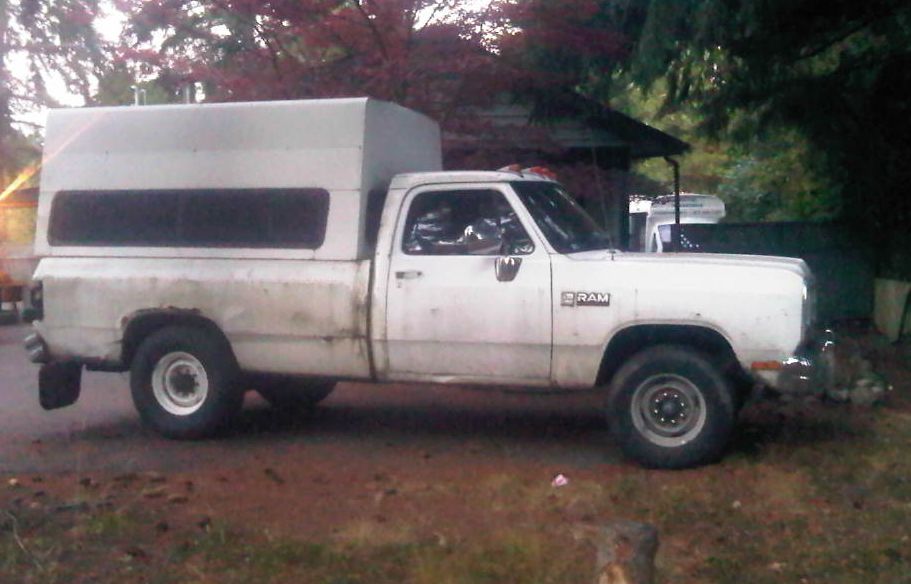

The white one. Mind you, this stuff was spread out over 2 years... didn't need it all right away. Checking the rear brakes was a can of worms as numerous bearings were worn out. The Lockright, Rancho's, tires, and coils were wants - not needs.
rough cost breakdown:
- starter $200
- tires $500/pair
- Lockright $500
- rear diff bearings and seals ~$300
- upper control arm bushings $10
- upper balljoint $20
- rotors $120/pair
- brake pads $50
- idler arm (probably didn't need it) $15
- shocks (rancho) $100/pair
- coil springs $200/pair
Attached Thumbnails Fix or sell help me make the decision-img00962-20110901-1723.jpg   Fix or sell help me make the decision-sept2011small.jpg
