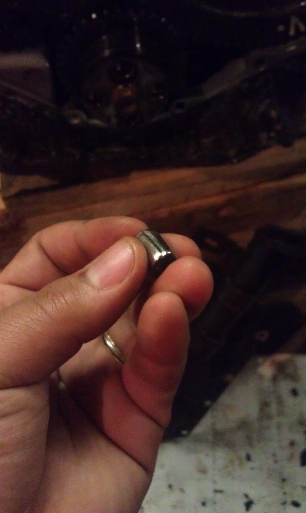

Cummins is off the chassis and on the stand. Decided to do all seals/gaskets including the head gasket as I think it would be a dumb move to have a 20 year old, unknown mileage cummins on a stand and NOT re-seal/gasket it.
As I started to pull off timing cover to inspect the KDP it literally fell through the gearing (think Plinko in Price is Right), hot the floor when cover removed. See attached pics of condition is was in. Seems to me I am a very lucky man, my father is even more so, as there could have been a serious issue at any time. The damage to the KDP is more then these pics show to.
