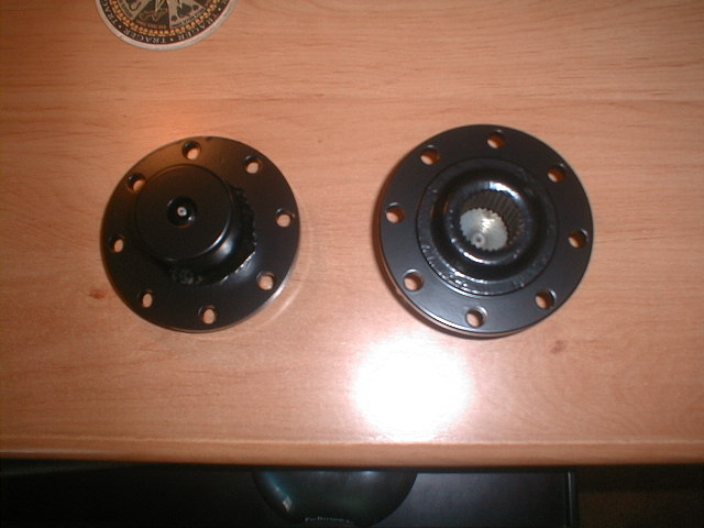

Time for a set of slugs.

^^^ Where do I get these? Need some. Been looking, PM me.

Yes, definitely need the EDM's. Soon, very soon.

Looks good. Next you'll be breaking the baby 1 1/4" 30 spline front outer axle shafts. Before you homebrew your 30 spline flanges, you might buy the 35 spline 1.5" outers and fab a 35 spline hub flange.

I am sure they will snap soon, but for now they hold. If I were not able to make the 30's for free I would upgrade to 35's now.

This guy makes 35 Spline, external drive flanges for the early Dodge 60's
http://www.cmperformancemachine.com/
