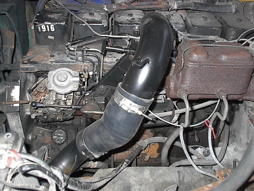

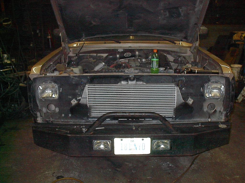

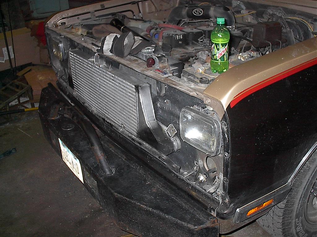

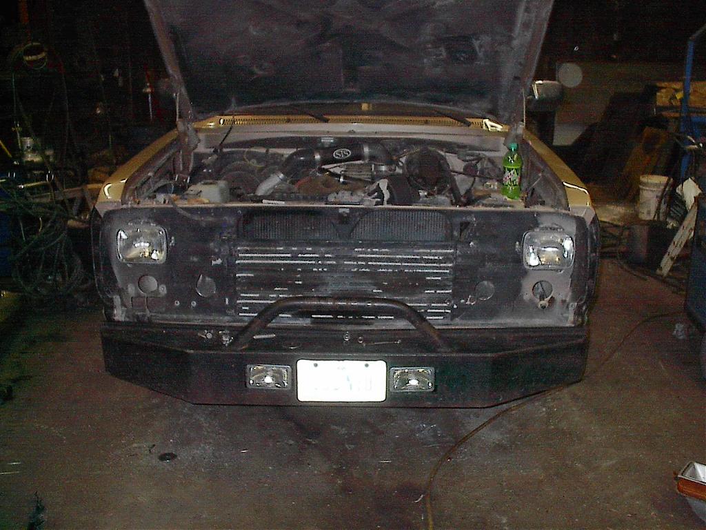

This is all the pics I got right now I'll have to take some more.
Attached Thumbnails FinallY Got My Intercooler In!-truck-001.jpg   FinallY Got My Intercooler In!-truck-004.jpg   FinallY Got My Intercooler In!-truck-003.jpg
Old Apr 20, 2010 | 12:38 AM
Thanks for the pics. Does the Banks intercooler come with brackets to help reinforce the hood latch area?
It appears that you left the original A/C condensor in place. How far out does everything come from the rad support with the IC installed?

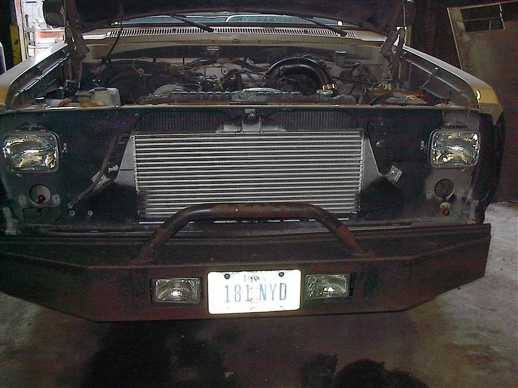

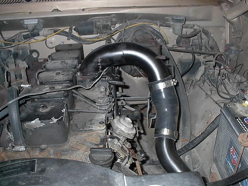

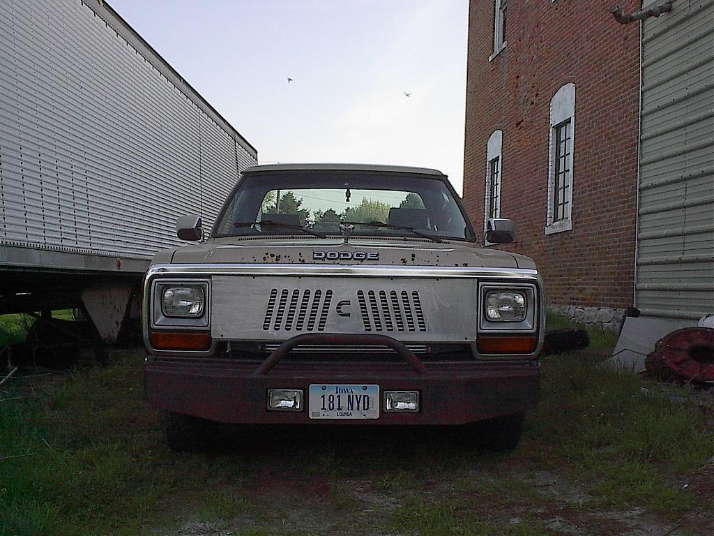

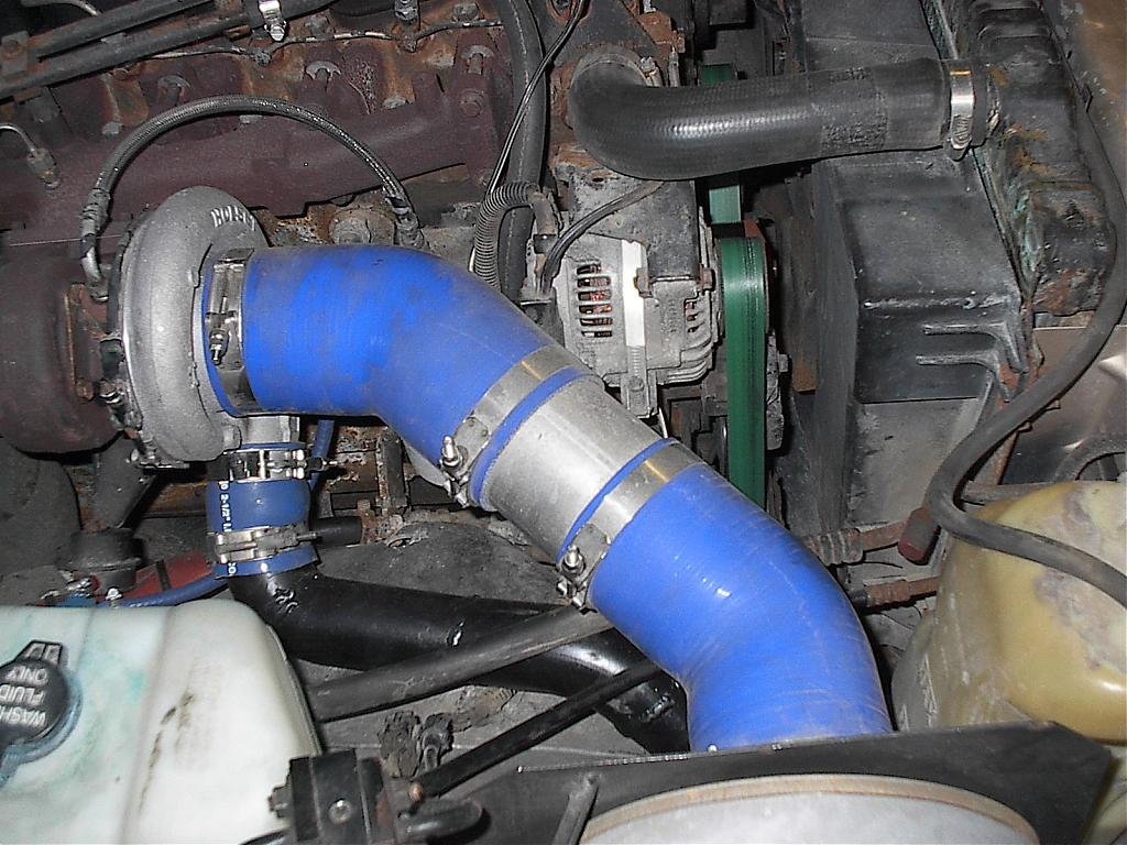

Well here's some more Pics. Grille ain't perfect but it works

Intercooler looks SICK
Looks like its readin to ruin some powerjokes lol... Have you noticed a big power difference cooler (EGT)s

I saw a 200 degree drop in egts. Didn't feel a huge increase in power but now i've got some room to giver her some more fuel.

Not to knock your grill, cuz I like it, but it looks like it could use a few more holes. lol
