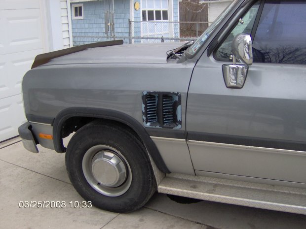

I've got the same type as shown in the ramcharger article.
I installed them about 2" above the belt trim and centered between the wheel opening and the rear of the fender.
I had a temp sensor under the hood and noticed nearly a 100* drop after the vents were installed. Didn't measure the floorboard area but it 'feels' cooler by my feet.

hey Unixcowboy when you installed the vents did you weld a mounting strip in as was shown on "ramchargercentral" or did you use some 3M adhesive tape to stick them in place?
Actually, when I got the vents, I was lucky enough to score a pair from 2 separate places and one actually had the mounting frame so I was able to drill 4 holes in the corners and bolt the that frame in using stainless hardware.
Before I bolted the frame in on the driver's side, I used it as a guide to cut the passenger side hole and I had the ears as a guide. I did trim the metal some to make sure the vents fit flat. By leaving ears I didn't have to weld anything - just careful trimming. I rough cut using an angle grinder with a cutting blade then trimmed and fit, trimmed and fit, etc using a metal file....
Extra work - yes. Worth it - Depends on you....I've had several comments from locals about the vents - all positive...
The paint is coming off the one in the pic. It was originally lite blue and I wanted black like the pass side. I found a place to bead blast it and powder coat it - debating on the powder but it sure would look good. The black stands out just enough against the gunmetal grey.
They really looked good 2 yrs ago - but 2 winters here in Mi have taken their toll.
