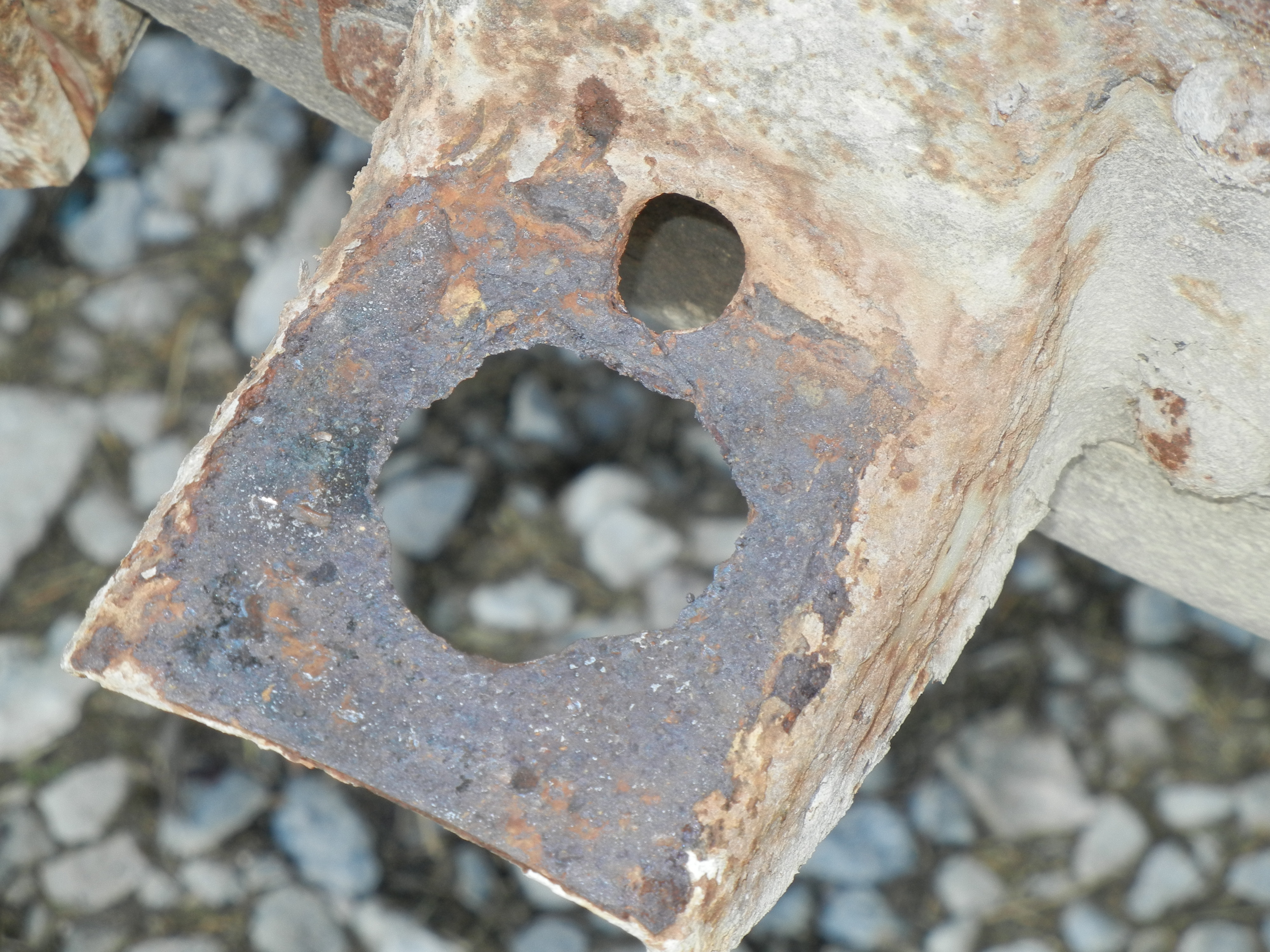

The raditor support isn't going to mover around to much by itself. It is attached to the body threw the fenders. Now if the cab mounting brackets are rusted out bad the whole body can slide around. This problem you can't see without pulling the bottom cab mount bushing off. Here is a pic of one of my cab brackets after I removed the cab.

Something is moving to get the fan into the raditor. There are almost 30 bolts holding the fenders/ inner wheel wells to that support. It can't move around very much at all without bending other metal parts. If the cab and fenders are moving as one piece. You will not notice it.
The truck being from TX doesn't mean it might not have that mount problem. Those mounts hold mud and water in.

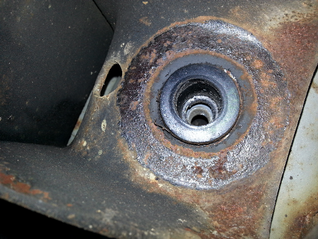

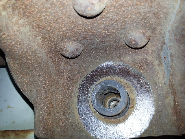

I took all the body mounts off tonight and there is no rust at all the mounts on the frame are perfect. I left the mounts loose and used a jack to push the cab foward as much as I could. I was only able to move it 1/4". That just came from the little bit of slop in the captured nuts in the floor that the body mount bolts thread into. I opened the hood to see how much of that 1/4" that I gained showed up between the radiator support and the timing cover. I was able to gain the whole 1/4" that I moved the cab. Then I noticed that the fan was stuck on the bottom edge of the radiator again and the fan clutch had blown up all over the engine compartment. I guess the fan got stuck on the bottom edge of the radiator again and then blew up the fan clutch when the fan could not turn. I don't really know how long the fan was stuck but I did take a 2 hour trip on saturday. For now I have removed the fan and I will just drive it the 2 miles back and forth to work. I think my problem is that the radiator support is bent. I can see where the grille is screwed to the rad support is about half an inch from where the original holes are. I noticed that after I noticed that where the hood latch catches on the hood is no where near center. Seems like the center part of the radiator support is bent toward the engine so I am going to pull it back out as soon as I find a clamp to use on it for pulling.

Here is what the cab mount brackets look like
