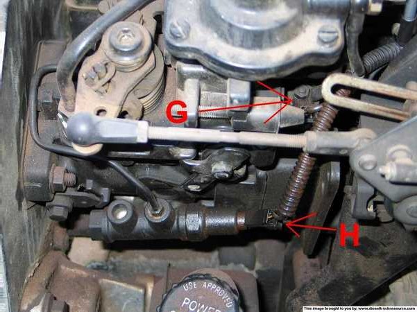

I would bet a hundred dollars that the wire to your fss is loose or off. It is the valve with one wire going to it on the back (drivers side) of the IP. It is G in this pic. Make sure that the little nut on top is tight and that you have 12 volts to the wire with the key on, good luck...Mark

There are 2 wires connected there, and they are both connected. I checked, and I do have 12v at the wire G with ignition. Is that the fuel stop? And should I remove it to see if it is working? Please advise how to proceed? Mahalo.

Yes, it is the fuel shutoff solenoid. Make sure that the wire is tight, mine was on, but not tight, take it off and squeeze the connector with a pair of needle nose pliers. Some people put an eye type connector on it for a more positive connection. Also make sure that the little nut on top is tight...Mark

I check for tightness, and all is tight, including nut. Should I remove the solenoid to see if it works? Or should I check something else 1st?

Try running a wire directly from the battery positive to the solenoid and see if it starts. Then go from there...Mark

I have 12v with the ignition on, so I have juice. I'm going to try remove the shut off solenoid and remove the plunger so it remains open so I can test. If engine starts, where is the manual shut off lever so I can kill the motor? Thanks!
It is just below the throttle shaft in the above pick...Mark

What is the "H" part in your picture? could this be part of the problem?
I removed the fuel shut off solenoid, took out the plunger and put back. still no start. What else could it be?
