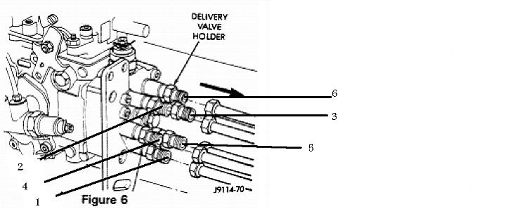

Which delivery valve on the back of the VE pump is #1 injector? Is it the bottom most drivers or passenger side? This is a pic of how mine is set up now. Is this correct?

I am going out to the shop in a couple hours anybody have a FSM they could check in?

Here ya go buddy, I even went down in the garage and found my cheat sheat I made awhile back and scanned it up for ya..lol But now I have it saved on the pc...so It is all good.. Hope it helps

It should be labeled with a "A".
"B" is #2, etc.

Yep finally got out to the shop (45mile away) and looked at the old 12mm head. Seen it was labeled as "A" on the lowest drivers side DV. Well that isnt my problem.
