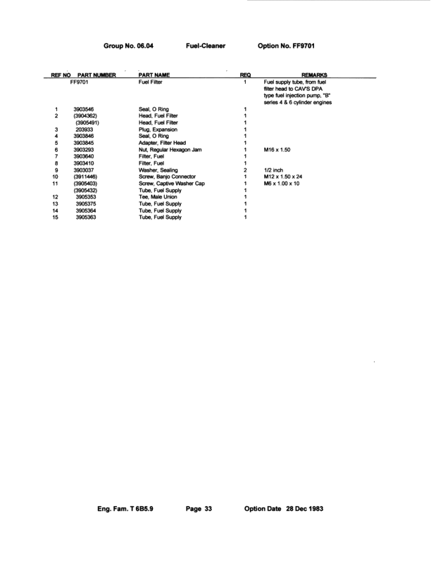

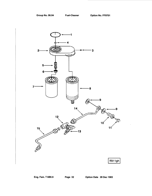

I think this is what you are looking for, it is on a stationary Fire Pump powered by a Cummins 5.9 6BTA-F.
The only issues I could think of would be the fuel line connections and maybe the bracket because this engine has a Lucas CAV injection Pump instead of our VE Pump, this engine also has a piston lift pump unlike out diaphragm style.
When you choose filters, look around and compare because different brands have different Micron ratings.
Hope this helps.
BTW was this what you were looking for?
Jim

Yep those are what I was looking for thank y'all

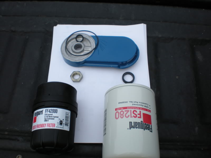

[IMG][/IMG][IMG][/IMG]
Old Mar 7, 2012 | 06:20 PM
Moparbubba's Avatar
Posts: 580
From: smyrna de
Got my set up
