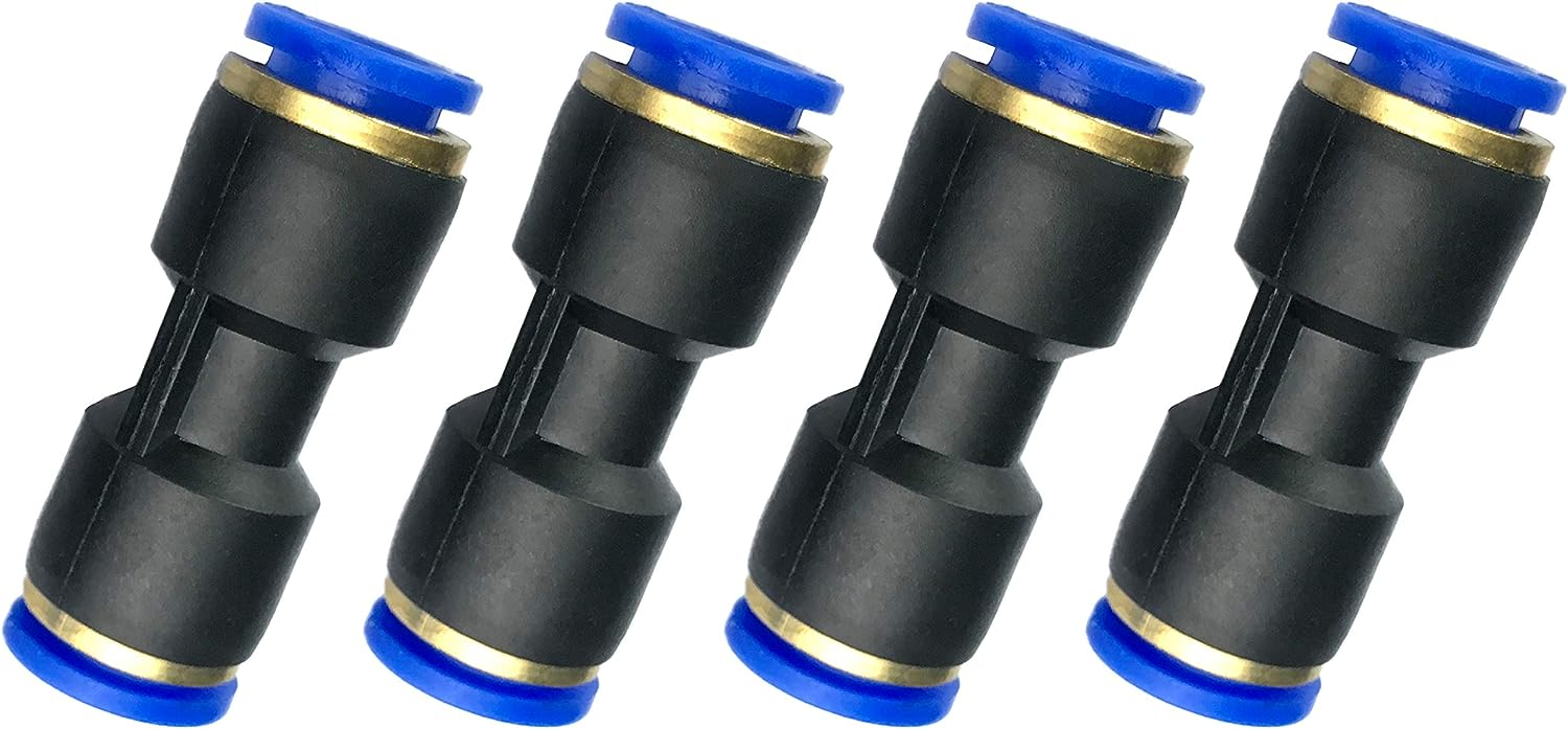

The quick connects can be saved. They actually have Sharkbite fittings for fuel. I have a Sharkbite repair kit on my '97 Buick. Been holding for almost 2 years. If you can find a 3/8" repair fitting get it. Wish I didn't pull my factory lines. I could have used them except my dumbaZZed black lab pit mix chewed the crap out of them.

I forgot what the quick connects look like on our trucks shop amazon and see
3/8" fuel line shark bite unions
