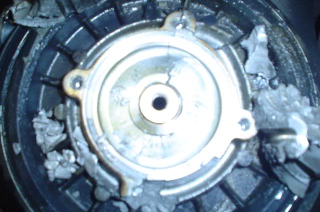

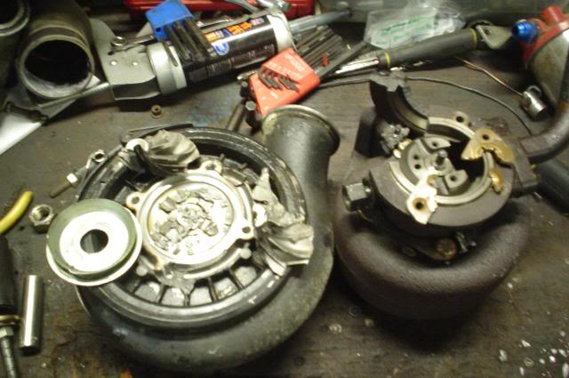

Old Oct 4, 2009 | 12:53 PM
boostedve's Avatar
Posts: 214
From: RISING SUN MD
here are some pics of the turbo
Old Oct 4, 2009 | 01:02 PM
boostedve's Avatar
Posts: 214
From: RISING SUN MD
im not sure if a piece made it that far very well could have.. we pulled the intercooler and ther was oil and pieces from the turbo on the turbo side the other side was clean
the exhuast side of the turbo looks fine doesnt look like it was ever touched..
