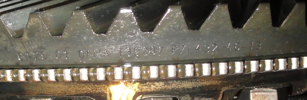

Originally Posted by MARF75
I'm in Michigan, that's long gone lol
Pull the diff cover. The gear ratio, and all the differential information is located on the outer edge of the ring gear. If you ever need parts, such as spider gear kits, etc, that alpha numeric number on the gear is what you will need to order them.
Mine is here. The spec number for my axle is T39287 I called DTS, and they had any part I wanted, and all the specs on the diff with that number
