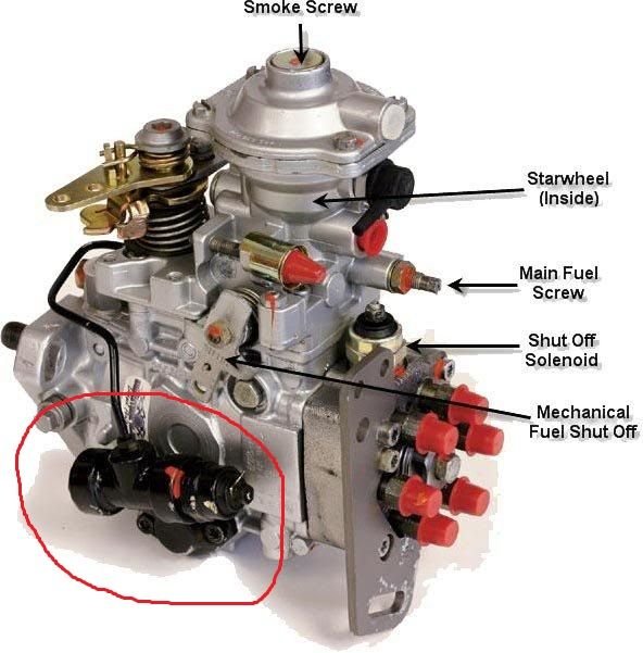

What is a "wax motor?"
As u2slow said the early non-inner cooled ve pumps required constant power to the ksb as they used a wax pellet to advance the timing for cold starts, as the wax melts it allows the timing to return to stock. The the inner cooled models have a temp sensor in the intake that supply's power to the ksb to advance the timing when the temp is I believe around 35 degrees and once it warms up the power to the ksb is shut off allowing the timing to return to stock

That little guy right there, non-inner cooled constant power, inner cooled power only when cold
