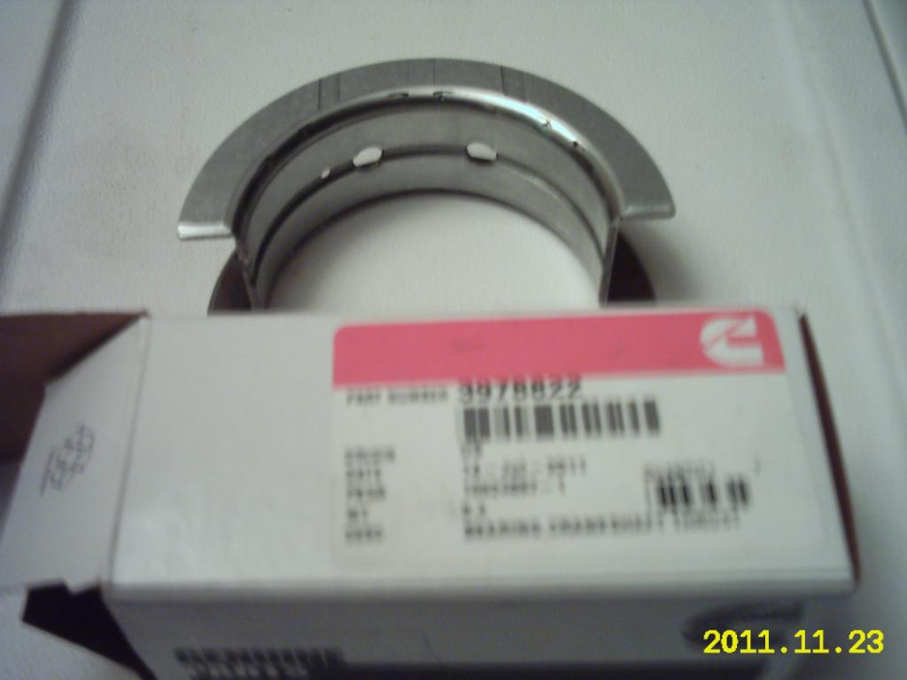

This is a common problem with the 4bt, the crank trust bearing comes apart and falls in the pan. This is more of a problem on engines with a manual transmission behind them. Cummins did come with a part to fix this, You have to call and specify what You need (the updated bearing not the old 3 piece bearing) since many cummins counter person do not know this.
Here are a few pics from the one I got for My 4bt but the problems seems to be the same on early cummins 6bt as well.
Now changing just the one bearing will fix the problem with the crank riding in the block but a new bearing with a set of used one on the crank will provably cause a drop in oil pressure or could starve it. The advise I received was to order a bearing kit and replace them all for which You might a well to a engine refresh (mild rebuild) since You will need to pull the engine anyways.
If at all possible do not run it in this condition.
Just My .02c.
Attached Thumbnails Crank thrust bearing-img_0016.jpg   Crank thrust bearing-img_0018.jpg   Crank thrust bearing-img_0019.jpg   Crank thrust bearing-img_0020.jpg   Crank thrust bearing-img_0017.jpg

By the way, the pictures that Exekiel69 posted are of the OLD STYLE main bearing. You can see that the thrust faces are attached to the shell with three dove-tailed tabs. The new bearings are a single u-shaped piece.
Yep thank You for clarifying that, after more than one hour on the phone with the cummins tech I still got the wrong bearing. There is a member on a 4bt forum a frequent who is a authorized cummins dealer and sells a complete kit for this particular repair and saves the aggravation from calling Your local cummins dealer and get someone who is ignorant of their own parts.
