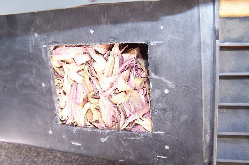

If you guys haven't done so clean out the plenum it makes a big difference especially if yours look like mine did.... Lets see if this works..

Mine looked like that too Grey Wolf...when I cut the hole in it...
