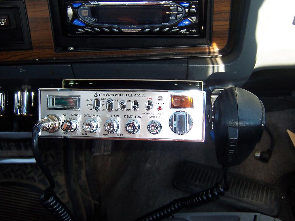

Well I got my cb in here are some pic's

Looks really nice man. Wish my truck was that clean.

looks good i like the brake peddle, shiney, but at least you still have the rubber cover.

How did you run the cables through the cab? Also did you use 2 seperate calbles of a Y cable? You have guts drilling into the dash

Thanks,guy's.Yeah I cant get that brake pedal cover to go back on....I just ran the cable under the cab up through the engine bay and through the grommet where the other wires go through into the cab.The antennas I bought ame with the cable that had a y cable at the antenna end.Hey no gut's no glory

Thats where I mounted the cb in my first gen. Its a good spot.

My CB is mounted further to the pass side under the dash & the ant is on the front bed rail. I like the dual box mount Idea thou.
