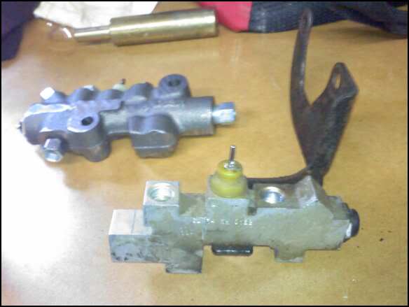

Originally Posted by Murf
You gotta honest to goodness prop valve on your first gen, and NOT the combination valve?
If so, Puuulllease tell me more!
I need info on what's stock and what ain't
Sorry for the Hijack Mark!
Murf
Well since mine is a 84 it has the regular proportioning valve, which is the cast piece in the pic. And is the same unit used on most full size mopar cars, van and trucks from the early 70's on up into the 90's.
Ma' Mopar based the proportioning valve on weight, so the full size cars, vans, and trucks were generally within the same weight category,so they all received essentially the same unit. I have confirmed this with the dissection of a proportioning valve from a 71 Chrysler 300 and a 86 dodge ram D250, and from looking at the units on many cars and trucks over the years.
I can snap a pic next time I'm under the truck...but it looks exactly the same as the cast piece in the pic.
Gotcha Thrash, thanks for the info. I'm just trying to figure out if the prop valve (Aluminum piece in the pic) is actually stock or not so I know which direction I should go when I put it back together.
Your town and country came with the same proportioning valve that every other MOPAR car of that era came with. From a lowly slant-six A-body to big block C-barges.
To eliminate the ABS on these trucks all you really need to do is pull the ABS pump/valve and connect the lines together where it is at, then plumb the proportoining valve into the feed line, I'd put it under the hood so it's easier to get to. You might want to dial in a little more bias when you load it heavy.
