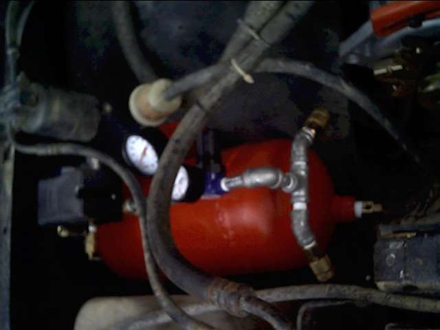

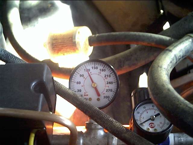

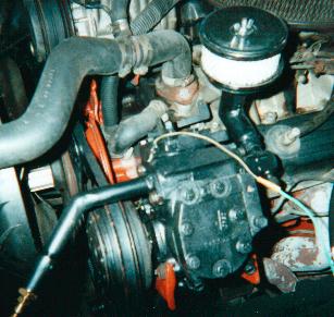

I know the engine is not a cummins, but here's some pics of my onboard air setup on my 84 ramcharger with a 360 magnum. The tank is mounted on the passenger fenderwell where the air filter is mounted for the cummins.
Attached Thumbnails on board air-comp1.jpg   on board air-comp2.jpg   on board air-comp3.jpg
