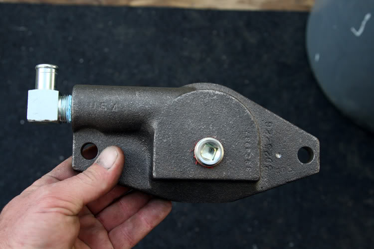

I replaced mine with one of those covers that has the fitting that would normally be run to the optional air compressor. I instead run it to the transmission heat exchanger.

^ that's the bypass I mentioned.
