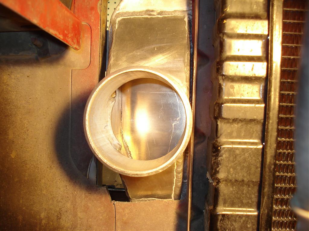

Best intercooler? Hands down Joe Hellmanns of Hellmannperformance.com. He has the dimensions on file. There is more to an intercooler than whats on the outside. The cores of his are very efficient.

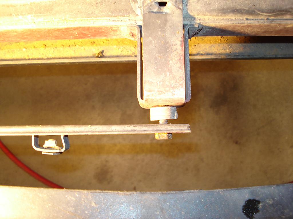

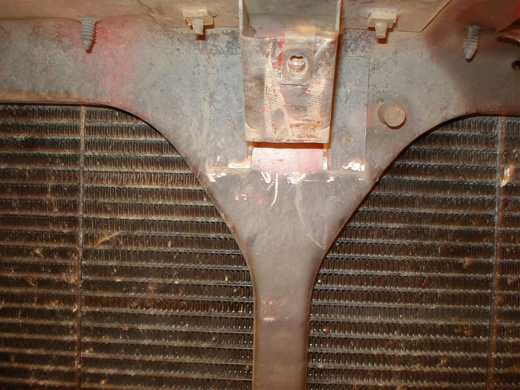

Pictures of 73* 3" 2nd gen compressor elbow modded to 90* next to a 3.5" elbow. Intercooler with mounts, a/c mounts, pegs on bottom for almost factory install. Some sheet metal trimming required. Ceramic coated compressor housing.

Source Automotive true 4" down pipe, PDR fuel pin shaved to approx .060", more trimming/grinding and washers used to "push out" center bracket. Also used washers on lower valance(?) and grille.
Mine was made with 3.5" inlet and outlets. You can get it made with 2.5" or 3" if desired.

Just remembered the ding in the front; UPS put a hole in it during shipment. Local radiator guy patched it up. Also to retain hood latch I cut a small square notch in top and removed the fins down to the first core row.
