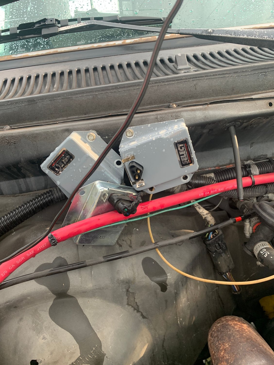

It didn’t fix all the problems. The ground straps solved the issues with the gauges, but the battery is still cooking. The picture should be familiar to most of you. Putting out 14.1. With the Chinese regulator. I switched to the third known bad regulator to get home. Is 14.1 volts overcharging? I plan to try to get a mpoar regulator tomorrow.

I would not be concerned at 14.1V. Depending on the load on the system and the condition on the battery it should be ok.
13.8V - 14.2V is what I would expect to see at any given time on a healthy charging system.
Those Chineseum flavored VRs are junk vs the Mopar units, but regardless of the flavor, running a ground from the back of the block to the VR mounting screw seems to buy them a little time.

Whats that big 2/0 wire for?

Have you put a meter on your battery to see what the voltage from the battery is? It is obviously overcharging. Mine turned out to be too much resistance in the green wire to the vr. The last 3 inches felt like a nail from over heating. The vr reads the voltage from the ignition switch. Run a wire directly from the battery. I recently destroyed 600 bucks worth of agm batteries with this problem...Mark

The starter is now on the other side. That is what the big 2/0 wire is for.

A problem which many have is there is a voltage drop between the ignition switch and the voltage regulator. This makes the VR think the voltage is to low and it boosts the field of the alternator to bring the voltage up. This is probably what is cooking your battery. This is what cooked my battery. I finally had to add a relay to the system to put the battery + directly to the VR. The original wire going to the VR from the ignition switch energizes the relay.

I agree with Edwin and Mark. I added a ground wire from the back of the motor to the ground at the firewall at the VR mounting screw. Then I started to strip the 2 wires out of the loom to the VR to connect the battery + to the VR. That is when the lid to the bucket of oil I was standing on collapsed into the bucket. Used oil from the 12v92 Detroit’s in my boat. So, I had to stop for the day and call in a hazmat team(wife) to help clean it up. I will be back at it Saturday am. But I think you guys are right.
