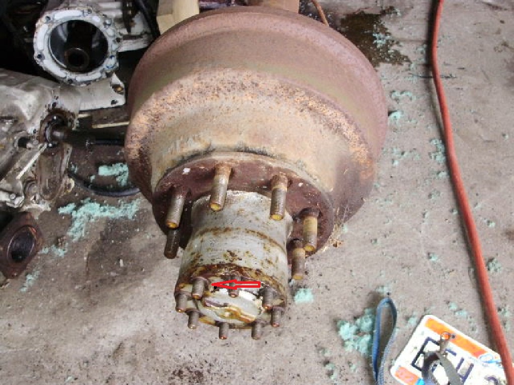

I've done the rear brakes on my Dana 60 and my Dana 70....and I don't recall ever seeing anything remotely similar to those cones. Where do they go?
Old Dec 27, 2013 | 12:15 PM
maybe368's Avatar
Posts: 5,311
Likes: 566
From: Phoenix AZ
They go on the studs that retain the axle shaft, here is a pic...Mark
Wow, learn sumptin new every day!
All my trucks had bolts that held the shaft in, no studs like that
I've never seen that
Yeah, I remember reading a thread where that was discussed. Maybe it's a w/d 350 thing...Mark
Thanks!! As the others have stated....learned something new today. Both axles I've worked on had bolts too...never see the studs before. But I can see how that would help center the axle.
