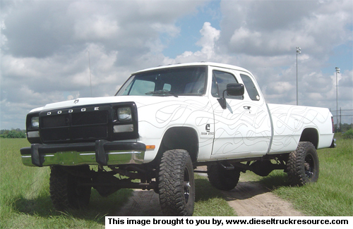

I bought the truck with the lift already on it and after some researched this is what I believe it has. 4-inch lift. Lifted with leafs. No driveline modifications. Instead of a drop pitman arm it has about a 3inch block over the kingpin. Since there is a wedge under the front leafs which I believe is to correct front dive line angel there is not much caster so it has bad driving habits. Planning on making my own longer front shackles to help get caster back. Hopefully I can pull this off with some clearancing on front drive shaft to avoid getting a new one.
with 35"s

Those flames look awesome! Wanna drive out here and paint some on my truck?

I meant squirrel painting flames like that on my truck (unless wannadiesel painted that on his truck?)

I had nothing to do with it. And Begle1 is correct about my painting skills.
