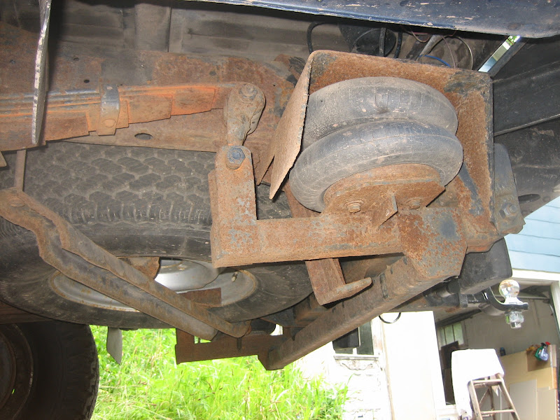

Sorry for the belated reply.
Here's a picture of my rear air suspension setup:
