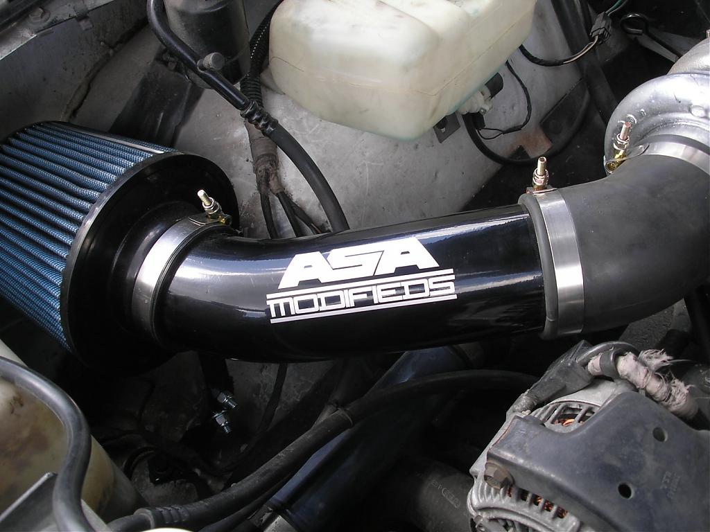

ASA. I got mine from Piers

ASA, I bought mine from the person who makes them for Peirs, but now you have to buy from Piers because he stopped selling them direct. It is a great setup.

They are about $200. http://www.pdrdiesel.com/catalog/Systems-37-1.html
Making your own BHAF setup is probably cheaper, mine was only about $120ish to make.
