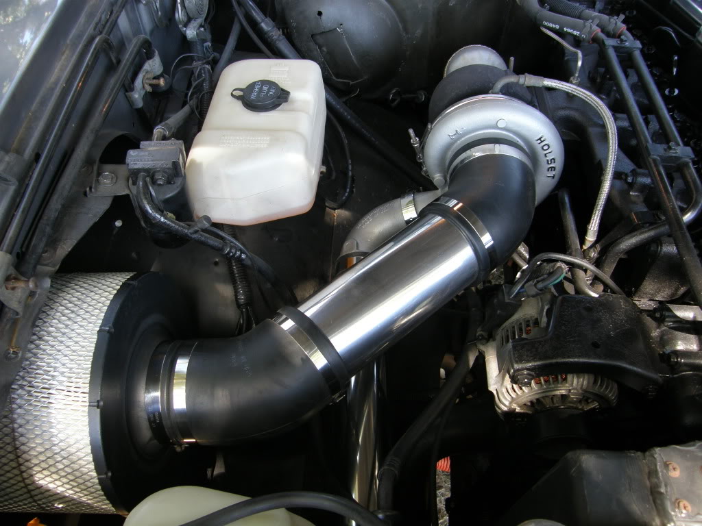

Old Jan 28, 2013 | 10:24 AM
1STGENFARMBOY's Avatar
Posts: 1,134
Likes: 139
From: extreem southern ILL
this is an intercooled system, but still you can get the idea, there are about 10 different part numbers for the filter depending on the brand, i change mine 1 time a year at about 50 bucks each.
the pipe is a piece of 4 inch exaust and i got the boots from here.
http://store.airflo.com/
Old Jan 28, 2013 | 03:01 PM
deanhinsley1963's Avatar
Joined: May 2009
Posts: 471
From: Hugo,ok.
I run the Duralite 105006 BHAF from airflo.com as well.
