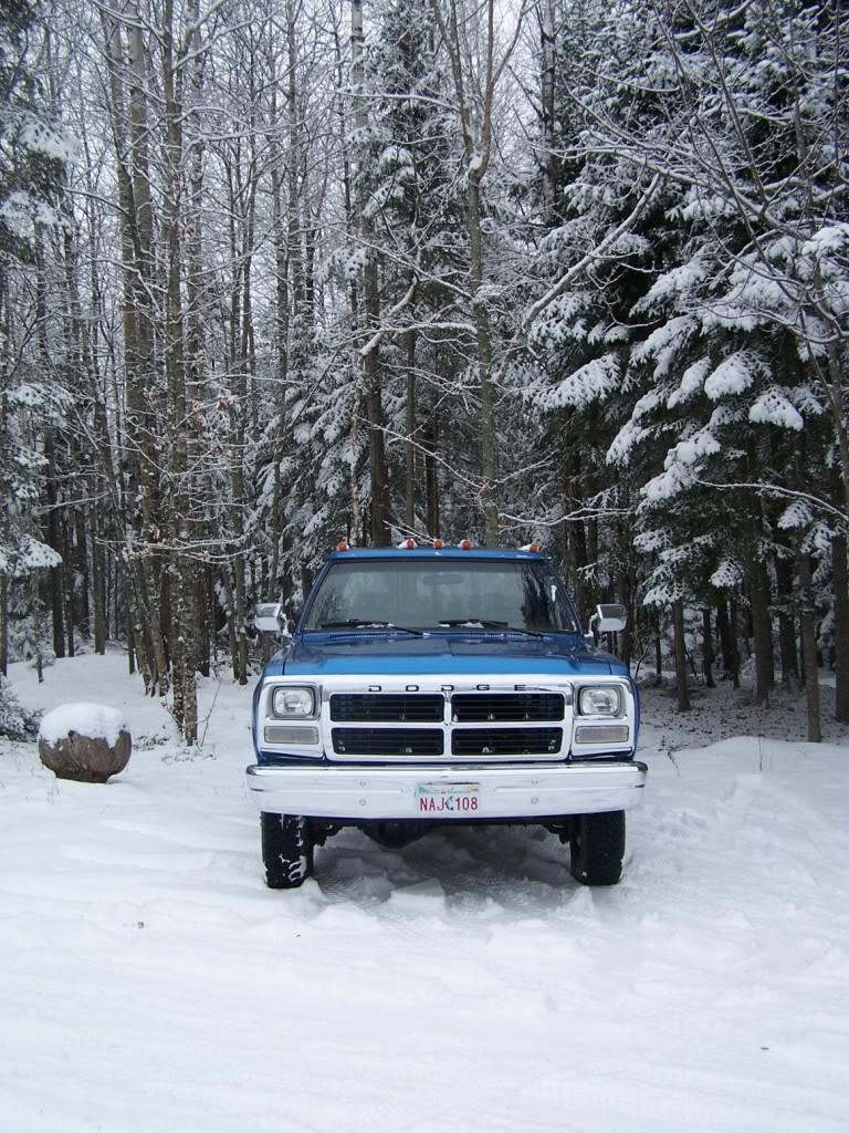

Here is a picture of my aftermarket grille. I just ground the back side of the tabs with a dremel and poped the letters off, cut the tabs and ground them flush and adhered them to the grille with 3M two sided auto body tape. Anyone with no knowledge of 1st Gens would never notice it as the factory grille is recessed.
