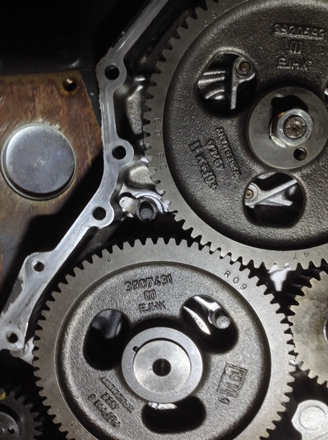

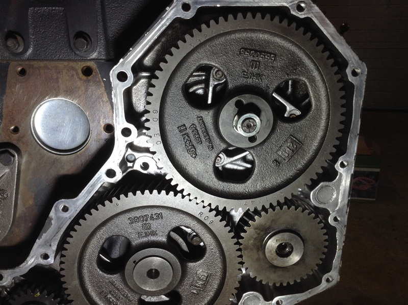

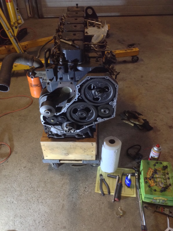

I got the timing cover off today.
Boy am I glad i did that!
I remember reading and seeing pictures in the previous build tread on this RC, of the cover being opened and a cool custom billet KDP tab installed.
He was making extra KDP billet tabs to sell for $20 IIRC.
I figured that the KDP was taking care of, but I could't tell if the cover was sealed up well after.
Well the cover was just bolted on again with the old gasket. The cover would have fallen off when I took out the last bolt if my hand was not on it.
Well someone must have wanted they $20 billet KDP tab enough to open it up again and take it out with the timing case bolt after the picture session.
Okay, I have now gone for question some things, to not trusting ANYTHING on this build that was previously done.
Luckily I had a 1st gen KDP kit on the shop shelf from TST that includes a newer longer case bolt and tab I can use.

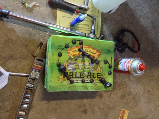

I also got all the case bolts pulled , cleaned, blue lock tight'ed and re-installed to 18 FT Lbs.
I will try to get to cleaning up the cover and re-installing with a new front crank seal on Wed.

Not cool... Not cool at all.
Yeah even after a good nights sleep, I am shocked and angry.
Who posts pictures of all the great work they do, then when they sell it they pull the parts back out to feel better about themselves.
Not even leaving me the case bolt. What if I assumed it was done right only to have the cover leak like a faucet and have the case under extra stress with a missing bolt?

BTW. I didn't use a tab. I just snotted up the case and made it unable to fall out. Cheaper.....
