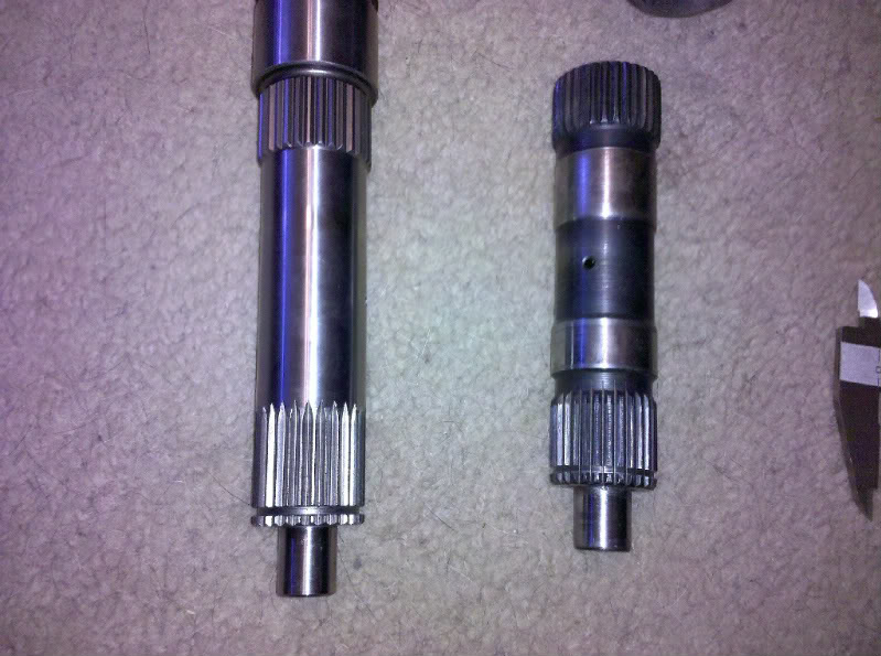

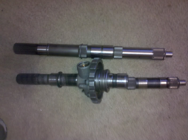

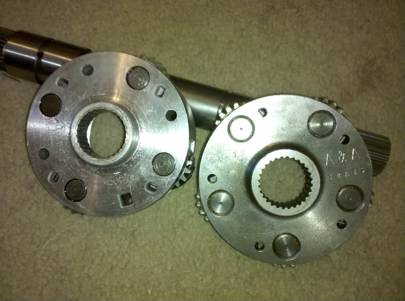

i dont think the 500 hp is a problem with 727. the huge amount of torgue of the diesel is the problem. have a buddy that i built one for in a 65 belv. which produced well over 500 hp. ran low 6s high 5s in the 1/8 mi. with 3400 lb car. trans was basically stock except for manual valve body. 700+ passes and one cracked converter hub the trans was still working fine when he parked it and went to a smaller car with diff. set-up
Old Jun 28, 2010 | 07:07 PM
RSWORDS's Avatar
Posts: 214
Originally Posted by DNRCustoms
Wondering if any of you 727 guys out there know of any tricks or maniditory upgrades that should be done while rebuilding one. I just picked one up with 24k original miles on it!! I am putting it behind a 500 hp p-pump!! I plan on a full manual valve body, upgrade to a steel planetary and not sure what convertor Im going with yet. I know everyone has a chubby for goerend, but I called there and wasn't to pleased with the customer relations!!. Any ideas welcome, ripping it down next week.
In my truck I have toasted a rear planet and a stock output. Input was billet from the 1st rebuild. Only on shop in the country sells a billet output for a 4wd 727 in our trucks... and its not cheap plus you MUST run a manual VB in the tranny (which you said already). Also upgraded to a 5 pinion planet gear. I have stupid money in my 727... I would go a different route if I was not wanting to stick to a straight up 1st gen (VE, 727, ect)
I broke teh output coming up on boost for a launch (around 15psi) and the plant on teh 2-3 shift with my reverse manual VB.
