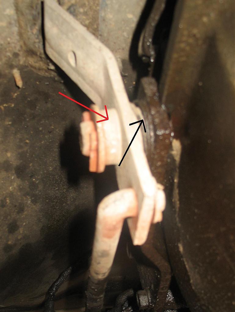

thanks for the responses. I hung my coat over it the other day to stop the annoying sound, but I want a more permenant fix.
Looks like the bushing at the red arrow is the problem, wiggles around a lot. Also the spring at the black arrow could be worn out. I'll see if I can rig something up and let you know how it works.
Old Oct 30, 2007 | 03:36 PM
Diesel Junkie's Avatar
Posts: 332
From: Silycon Valley
Super common problem....
Lots of people talk about adding springs and stuff to the linkage, the natural thought is that the problem stems from the pivot point that you point out in the picture, I tried that, but replacing the likage did the trick for me.
I ended up replacing the bent cotter pinned rod with a couple of those cheap spherical joints(hiem joints) and some all thread, and then bolted the spherical joints to the T-case and shift lever.... works like a charm.... also gives a much better feel for the T-case shifting... no guessing what position its in.
Another popular thing is a twin stick conversion that lets you use front/rear high and low independantly..... there are a few companies that make these for the 205,,, cant remember their names right now though.
